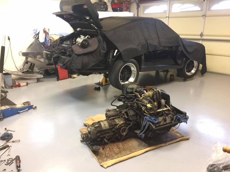

And she's out. Luckily a friend rang me up and asked what i was doing. LOL So, naturally i invited him over.
(and luckily he was there to help)
I'll start tearing down what i can with it on the floor..... and making a list....

And no bumper removal. NICE
Wait, doh, you have access to a pro-shop to use those giant jack stands.
Congrats!

nah, these are just my regular stands.
Lemme know when you're done with that engine yoke.

Nice...you are in for some fun..Did this 2 years ago and I am envious..Miss having a winter project..Look forward to this story...Cheers
