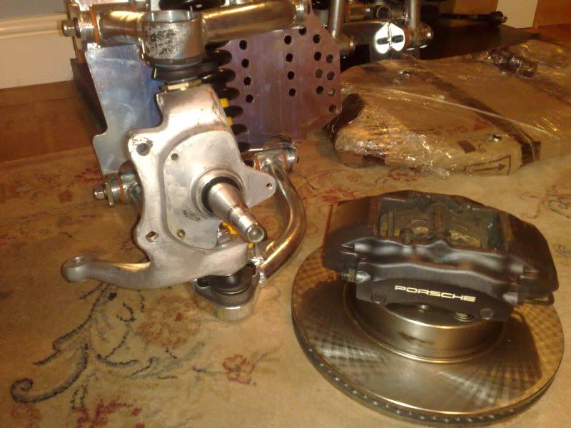

Broke a caliper bolt, now what
Well I decided it was time to do the brakes and rotors on the old boxster so I ordered all the parts from pelican of coarse.
Did the rears, no problems, got to the left front and man those caliper bolts were tight. I of coarse grabed my long 1/2" torque wrench and figured that would do the trick.
Well obviously the bolt broke. It started, but continued to be difficult. Then it snapped.
So what am I looking at to get the bolt out? I'm going to just go ahead and call a local wrench and let them fix my screw up. But what's the trick? Both bolts are frozen in there, except one is missing the head.

I broke a caliper bolt on a commuter car once. The bolt went through the spindle and then into the caliper bracket.
The spindle hole was not threaded. So, all I had to do was to drift punch the bolt shaft out of the spindle hole.
The caliper bracket slid off with the bolt shaft stuck in it. I replaced that part, since there was no way that busted rusted bolt was even coming out.
Not sure if your car has the same design, but just verify. With the bolt head off, the caliper might come free of the hub/spindle, and come right off.
See how the 2 holes on the left are not threaded?

Apply heat to the one that isn't broke and drill and re-tap the one that is.

Big heat. If you ain't got it, pay to have it done.
However, check out what sugarwood suggests on the bolts.

Did you get my first reply? You may be able to remove the caliper, since the bolt head is gone... Find out if the spindle is threaded.

The spindle is threaded. I could get the caliper off by breaking off the other bolt. But i figured I could drive a few miles with the one bolt still holding the caliper on.

I agree it is less stressful to just punt before you make it worse.
But, if the spindle is threaded, then how would you get the caliper off by breaking the other bolt head?
Both bolt shafts will still be threaded into the spindle.
That would be near impossible to remove.
Are you 100% sure the spindle is threaded?

The bolts slide through the calipers and screw into the spindle.
The rear bolts were threaded all the way to the head. I'm wondering if they couldn't put two nuts on and with heat be able to back out what's left of the bolt.

The caliper bolts to # 1.

If them peeps are decent MIG welders they can weld a cripple hex head on it. Torch up area with real heat and pop goes the weasel. I have done this successfully and I am pathetic at welding. But I do gots me a welder.
I bet under $200. Have them pop the other side loose as well.
