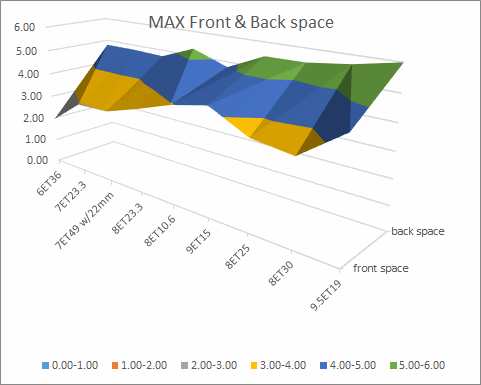

Bill Verburg 05-12-2017 05:31 AM
Originally Posted by gomezoneill (Post 9583005)
Okay one last question. What size 17" wheels (width) would you use on a 1985 Carrera?
What size tires would you put on said wheels? Front and back.
Different opinions welcome.
If purchasing 17s for an SC/Carrera
front
8 ET25 to 31, higher ET provides more fender clearance for the tires
225/45 to 235/40
rear
9 ET12 to 15, again higher ET provides more tire clearance at the fender
255/40
9.5 ET19 fits in back as well, but there is little to no leeway wrt ET, tire 255/40 to 275/35
sweet combos are
8 & 9 w/ 225/45 & 255/40, 9.5 is nice too
8 & 9.5 w/ 235/45 & 275/35
http://forums.pelicanparts.com/uploa...1494591979.gif
the 8ET23.3 Fuchs can be fitted bin front but they aren't a happy fit and leave very little tire room at the fender, in the charts above they look to be a good fit but it's an illusion caused by the narrow lips used on Fuchs
