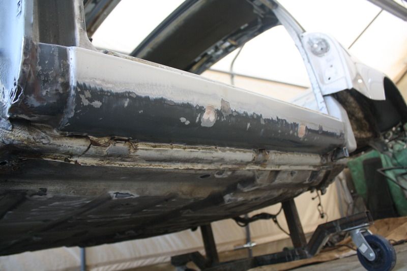

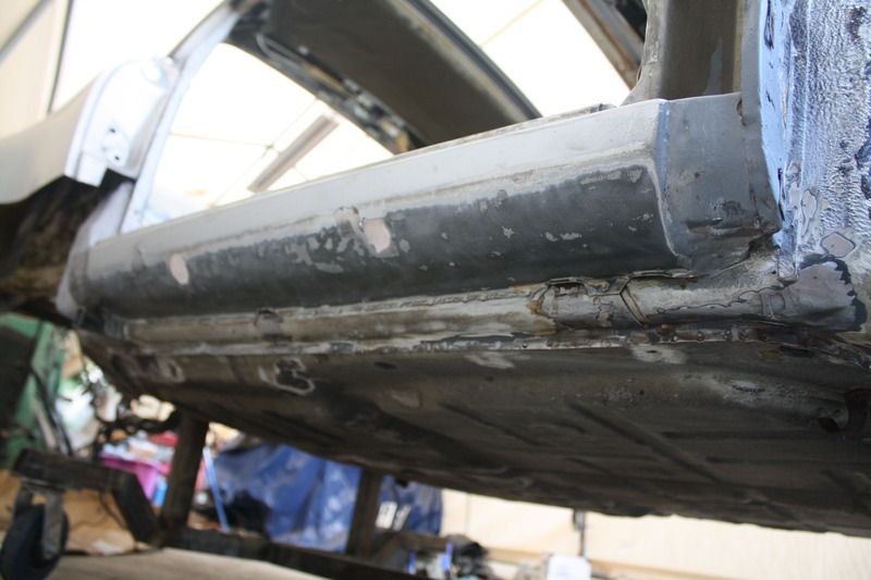

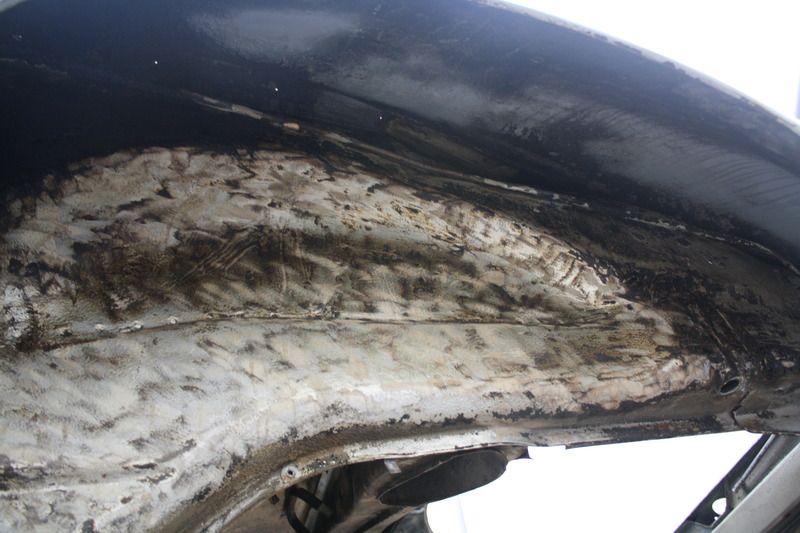

Trakrat - The cost to have somebody who's done it before repair the rust is going to be very expensive - it is a ton of work. I'd suggest getting a welder and DIY if you have the time. Lots of work, but rewarding - plus you know it's done right!
Here's what the rust looked like. If your car looks like this, know that there are around 14 panels under this all laid over one another like lasagna, and you've probably got rust in at least the top few..
http://i88.photobucket.com/albums/k1...pstly1qh4l.jpg
I thought the other side was good. A magnet stuck to it, felt solid, no rust.. Started digging into it a little deeper because I had to address the rust in the rocker, anyway.. Popped some spot welds and took a peek..
http://i88.photobucket.com/albums/k1...psjjvvslzs.jpg
Oh boy.
You can kind of see the goo they shot in there to fill the holes back when they had the car painted in '01. Big globs of caulk or seam-sealer, maybe a little layer of bondo smeared on top, then that panel spot-welded over it all. Looked good, a magnet stuck to it, sounded solid when I tapped on it!
http://i88.photobucket.com/albums/k1...psbp0xtg1s.jpg
So, the fix for this (at least how I did it) is:
- Cut the body panel from about halfway up the wheel arch to the door frame, then down the rocker just behind the jack tube. Cut straight, with a small blade
- Drill out spot welds in the doorsill for your new removable panel
- Pull it off and have a looksee.
I don't have a pic of the carnage on the drivers side, but it looked like the passenger side (not quite as bad, but you know..):
http://i88.photobucket.com/albums/k1...psy8yi9max.jpg
So now that I knew what I was dealing with I started cleaning it up and figuring out a plan of attack. I decided to keep as much factory metal in there as a majority of it was still surprisingly solid! I cut out chunks of it here and there and thought about how I was going to need to build it up on my way back out. I tried to keep all the cuts straight because it's much easier to build new panels that fit nice when the edges are straight.
http://i88.photobucket.com/albums/k1...ps5camw8bk.jpg
This is that zone cleaned-up and ready for patch panels (which you can see I've been busy mocking up in white posterboard)

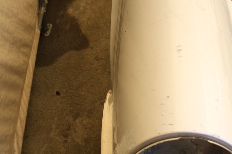

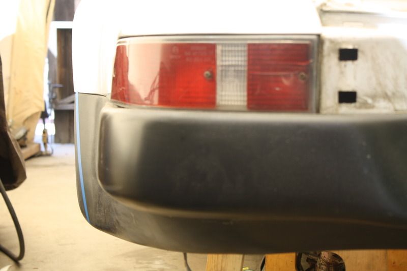

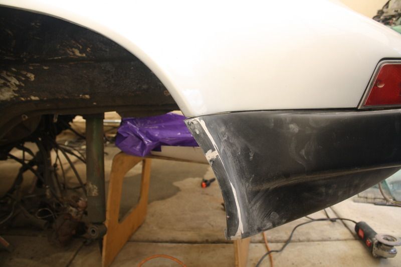

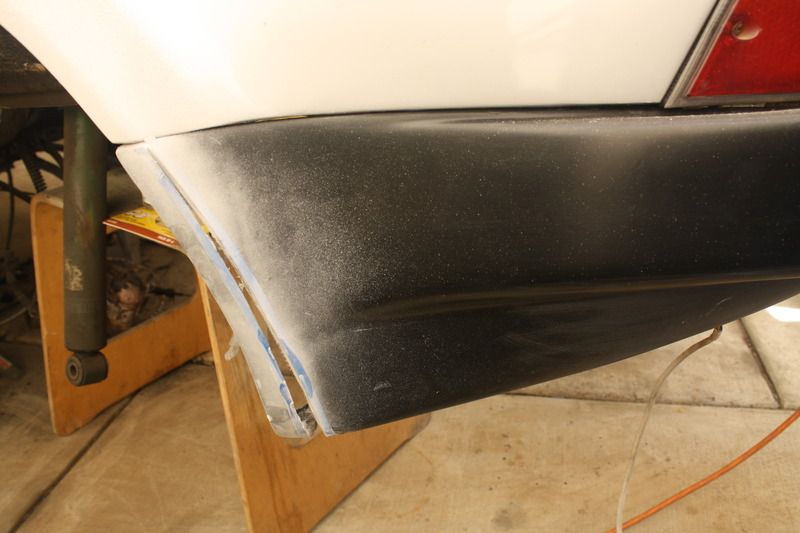

Fiberglass sometimes sucks.
Rear bumper flare didn't follow the contour of the body. From the top edge to the bottom it went nearly vertical, meaning it didn't wrap "under" the car like the stock stuff does. Maybe it's a function of fiberglass being built for track cars, to save the paint? The quality of this part was very good otherwise, so instead of ordering another unknown fiberglass part I decided to fix this one.
See here - tape line marks the contour I was after:
http://i88.photobucket.com/albums/k1...ps9mqyva3d.jpg
My method of fixing was - Cut a pie slice out, just behind the lip.
http://i88.photobucket.com/albums/k1...pssxinxlo6.jpg
Sucked in at the bottom, flush with fender lip at top. But now the radius is jacked and the lip is still fatter than the body.
http://i88.photobucket.com/albums/k1...psmdghtylp.jpg
Once I got to that point, I cut the lip all the way down (a little more out of the top), and stuck it back together. Got the radius right and the lip was the correct thickness. Somehow didn't shoot a photo of this..

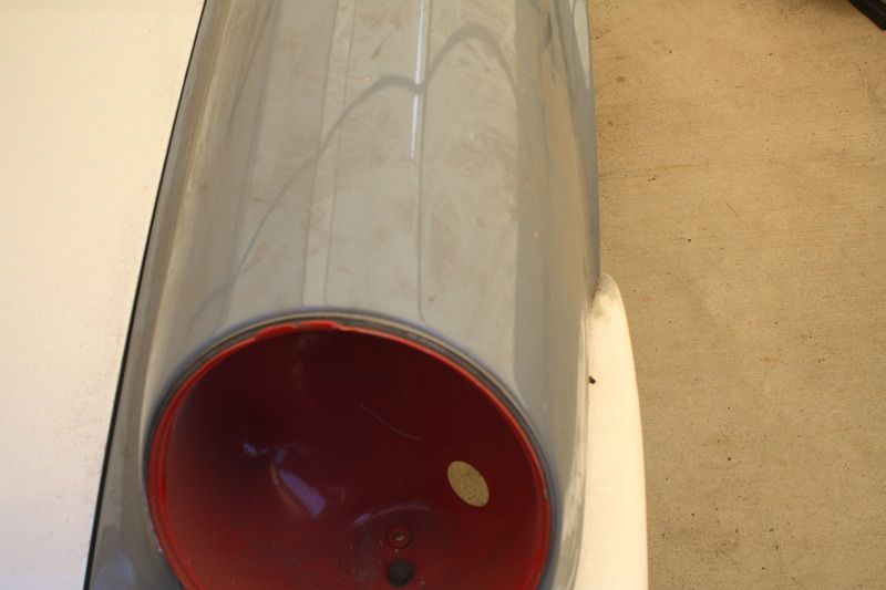

On to the front:
IROC-style for a narrow-body car. Looks just like the silver car posted earlier, but mine was 3/4" too wide.
http://i88.photobucket.com/albums/k1...pslcx0rfft.jpg
http://i88.photobucket.com/albums/k1...psndrtya7z.jpg
Solution was chopping the offending 3/4 out the middle and sticking back together and reinforcing with glass mat and weave. This bumper also needed a lot of love - not nearly as nice as the rear.. bubbles in the gel coat, dimples, pressure cracks.. this took a full day. Here it is, done.

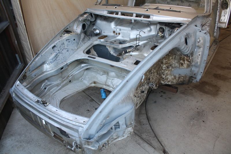

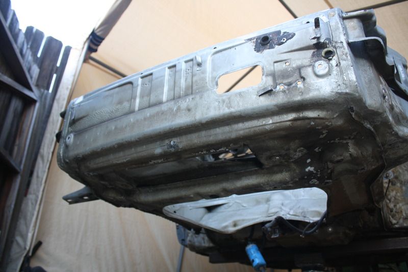

Now that the fiberglass was straight I turned my attention back to the body - filling holes and stuff. When you remove the rockers/skirts/whatever you want to call them on these cars, you're left with a quarter-size hole and a bunch of small screw holes in each side, and a lot of undercoating. I wanted smooth rockers with no undercoat, so I wire wheeled it all off, and filled the holes. You can see a couple dabs of bondo and the smooth rocker in these pics:
http://i88.photobucket.com/albums/k1...ps7jayxabr.jpg
(Note factory e-coat - if you strip paint on your car, I recommend not getting too aggressive and burning through this stuff.. it is great at providing protection for the metal underneath)
http://i88.photobucket.com/albums/k1...psnsfngx5y.jpg

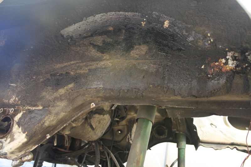

I wire-wheeled, treated surface rust and blended all the nicks and scrapes in the undercoat while I was filthy. Prep for undercoat touch-up.
Same deal when you get rid of the power flag mirrors - a bunch (5 per side IIRC!) of big holes. I made plugs and welded them in, skim layer of bondo over the top.
Also got rid of most of that asphalt goo. Hot day and a dull, flathead screwdriver was my method. Maybe some wire wheel. Pain in the dick. Factory undercoat looked great underneath, though!
http://i88.photobucket.com/albums/k1...ps7gxd5rfz.jpg
http://i88.photobucket.com/albums/k1...pshny7mrck.jpg
I also pulled the rest of the wiring, fuse box, and all the parking brake, brake lines, heater cables and boxes out.
No damage or rust up here. Awesome.
http://i88.photobucket.com/albums/k1...psjcb504jv.jpg
http://i88.photobucket.com/albums/k1...psyjcs6pw5.jpg
About ready for undercoat and off to paint!
