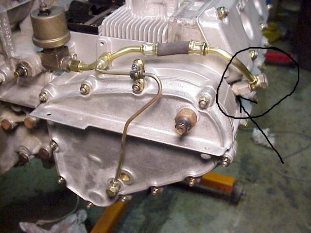

It's true it is no where near this area HOWEVER, oil can run out of this area, and it gets directed either down the side of the back engine tin, which would be right in the area he showed. The other pictures of the studs on the valve covers happen to be the lowest point so often oil will end up on those studs even if it originated from another area. Warped covers can cause this, but he has turbo covers and new gaskets. I'm not ruling out the valve cover gasket, but before gooping it up with RTV, i'd look for a few other suspect areas.
Firstly, check the drivers back of the engine bay tin, back by #3 cylinder. There's a plug there that can sometimes leak.
Secondly, there's an overflow pipe off the back of the CIS airbox that directs oil that get's puked into the airbox via the overflow hose coming off the oil tank and into the side of the airbox on a 75 CIS setup. Take off the airbox, and look if you have oil in there. look toward the back, you can see a little hole. Reach around the back side and feel that the hose is connected to this drain hole to a nipple that sticks out of the center of the back of the firewall.
If you recently changed out the valve cover gaskets, that means you drained and refilled the oil. If you slightly overfilled it, when you run the engine, oil will splash into the airbox and possibly make it's way down to this low point.
I mean yes, simple is always preferable, but just some more info to check for you.
Lastly, do you know if you have the oil restrictor upgrade on the cam feed lines? Just for my own research.

Duane, the potential leaks on your picture makes sense and in my engine, the other side of the tin (circled on your picture) is exactly where i noted that the section is humid: above the valve cover.

The other oil leak looks like from the camshaft oil line fitting to the engine .You can have the trought bolt tight but the leak is here.

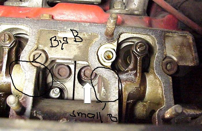

This^^^^^^ Rocker arm shaft especially since the engine was overhauled. They're either not tight enough (21' lbs) or positioned wrong. Many rebuilders don't tighten them to the correct torque then they walk out of the bores.

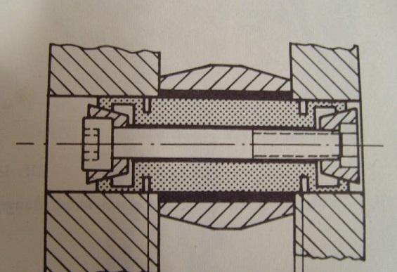

Hi..it is not hard..remove the spark plugs wires.Then remove the valve cover and look inside by using a mirror.Look at the rocker shafts for wetness.You can put on allen wrench to see if they are tight.But before that look if they are in the right place.The pin should be slightly showing on the smaller bang.
Like on this picture all pins have to bee to the thinner side....
