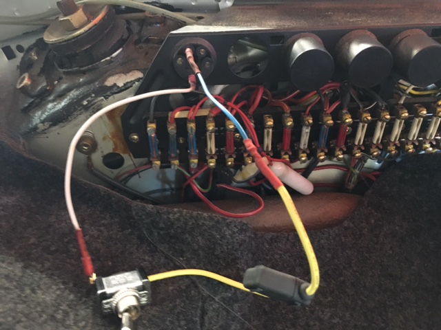

83_Silberpfeil 04-02-2023 03:13 PM
Adding foto of my jump wire set-up for the FP relay jump test
testhttp://forums.pelicanparts.com/uploa...1680473577.JPG
PeteKz 04-02-2023 06:41 PM
Did you check for 12 volts at the hot pin in the relay socket? Turn the key back on and check that you have voltage to the socket. If you do, then try jumping from the battery directly to the fuel pump pin in the relay socket (through your fuse setup). If it works, then you have to trace back to the fuse block to find what is broken or disconnected. Double check that FP fuse is good.
If it still does not run, then you will have to jack up the car and take off the splash cover and run a wire from the battery directly to the fuel pump. Measure the ohms to ground from the FP to make sure that's not causing the problem (should be zero ohms). If the FP runs, then you have to find where the wire to the FP is broken, or a corroded connection. If the FP does not run with 12 volts directly to it, then it is bad.

83_Silberpfeil 04-02-2023 09:59 PM
Pete/Tony --- thanks both for replying w next steps.
Pete --- No, I did not check voltage at all. I'd like to try that next. And, it sounds like you and Tony both are suggesting the same.
So, using my jump wire, insert one pin into #30 (as Tony mentioned), and the other pin to the +positive lead on the battery?
Then, for direct battery to FP test --- battery positive terminal to FP positive terminal?

I made several “typo” in the test #3 posting and nobody noticed the mistakes until I noticed them. In short, continue reading further down the thread until you read the correction I posted.
Tony
PeteKz 04-04-2023 11:43 AM
Jonathan: I'll anticipate that you will go under the car and check for 12 volts and ground at the fuel pump terminals. If those test correctly, then your fuel pump is bad, but here is one other thing to try while you are down there: Whack the fuel pump with a small mallet or block of wood. It may start running again. If it does, it may continue to run long enough (weeks? Months?) to get the rest of your work done.
