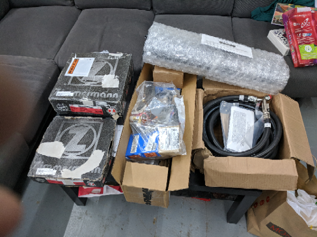

Hi Guys,
I'm a proud owner of this 1987 Carrera, its bone stock with nice factory options (electric sunroof, electric seats, ocean blue with white ivory interior and dark blue dash) :
I'm not new in this forum, in a matter of fact, I always buy my parts from Pelican, and I just got a large consignment from them :
I live in a very hot climate, where in summer the temps could be as high as 110F, and when in drive in these days I can see the temps will rise upto 2/3 of the sweep (but it will not reach the red area), my car came with a factory oil cooler with fan in the front, but I still feel its not enough, is there any kit that can improve the cooling capacity of the engine in hot climate?, I want my car to live long and yet I want to drive it when ever I want to. I'm thinking about a second oil cooler maybe? or an updated engine cooling fan that could flow more air?

There certainly are dual oil cooler setups out there. Example:

I personally think that you'll be fine with the stock set-up if its working as designed and you have no rodent nests behind the fan on top of the cylinders. I think your fan is as good as it gets. Our cars cool very well in my opinion and its not a problem unless the temp actually gets too high. I suggest you "wait and see" vs fixing what may not be broke. More modern oil surely helps some also. No problem getting that motor hot !
Bigger problem is that heat cooking you inside. Factory AC not likely to help at 110 outside.
Quick added point. I've done track days at AMP when ambient temps were near 100 and I've never had temps go red. Our cars are not quite that delicate.

For my car an 87 Carrera coupe which is venetian blue I needed additional cooling and used a lower temperature oil cooler switch without a manual switch. The background and it's use is explained here - low oil temp front oil cooler sensor p/n please.
Another good thread oil cooler fan t'stat and switch installation.
Before adding the lower temperature thermostat oil temperatures would get up to about 260 F on the hottest days now only to about 230 F.

take note if the temp drops when driving vs sitting. the engine tstat is often overlooked and this can be an indication of one that is stuck if the temp does not go down while driving. it can take 5+ miles for it to drop.

Oil cooler temp switch.
Nason temp switch.
210F Close.
197F Open.

The first thing you should do is check to see if your external thermostat is working with an IR gun. The next thing you should do is check for rodent nests behind your fan with a borescope. The next thing you should do is figure out when your cooler fan kicks on (I think the stock fan controller is set to engage well over 210°F).
When do your temps become excessive? Is it when you're hard on the throttle or stuck in traffic? If it's the former, cooling will benefit from an additional oil cooler (but this would be surprising if all is working correctly). If it's the latter, cooling will benefit from a better fan. The stock fan has been monstrously outclassed by some $50 modern fans.
Changing gauges will not increase accuracy—they all come marked with temps. 180°F is a bit below the first tick. 210°F is a bit above the first tick.
