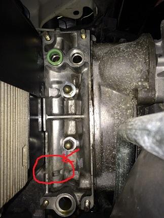

Recently took my car to the local air cooled Porsche mechanic for an oil leak, he replaced my oil cooler for lots of money.car went back to him a week later for the same oil leak, had the cracked case by the oil cooler seeping.the backside has been sealed up. Still have an oil leak.it does not seem as though it’s coming from the top . It seems as though it is something behind the oil cooler? Can’t really see.does the backside where that case crack is leak also?

Get some engine degreaser and spray the oily areas. Pressure wash and then look for origin or leak (s).

Could be from the cooler seals. BTDT I'll find the thread that I posted.
As you are not doing you own mechanic this can get very costly. Like Rahl mentioned, clean as much as possible to see where its coming from.

You didn’t say what year.
Behind the oil cooler is a case defect from the factory. Porsche issued a service bulletin on it. It has been covered here many times. Search for oil cooler defect TSB and you’ll find posts about it. When you take the oil cooler off you will see a little indention on the left side of the case where the cooler mounts. There will be oil seeping from that spot. Clean it good with a degreaser and then use some JB Weld to fill it in.
There has also been some debate about the type of orings to use on the high pressure tubes at the top of the oil cooler. The green type seem to fail. The reddish brown colored ones seem to be the preferred. I don’t think it matter on the lower low pressure opening.

Hi..the amount of oil leak you have ,looks like it was there for a while as we can see the burned oil on the EGR pipe.
Do your self a favor.Take a mirror and look your self on the top of the engine .It is called here the triangle of dead--look it up.
Also the oil could be leaking behind the oil cooler from the same spot as you have put the duck-tape on front. It is on every 911 from factory when manufacturing the engine cases.The earlier models had rubber plug later model did not leak.
look here on picture.To seal it use JB weld epoxy.
The replacement of the oil cooler is a good question.Did the mechanic gave the old cooler back?
Ivan

I don’t think tape is the answer.
Run it from cold until the thermostat opens. Are you leaking while cold, or after the thermostat opens? Wrench should have changed the seals on the cooler when he had it off.
There is a natural leak potential behind the cooler opposite where you have tape.
Apply JB weld under the tape after cleaning and wire brushing area
Most important, when is it leaking

Yes... My best guess is that it’s probably leaking on the opposite side of where I have the duct tape, but that involves removing the motor again.can’t really see up in there.and it is not coming from the top of the motor

The puddle on the ground formed after driving it for an hour and then parking it overnight

Tirwin ,where the heck did you hear about the green o rings being bad.These types are the only o ring you should ever use on Porsche 911 engines.
If you click on his garage you would know what year is his 911 also being there EGR pipe for air injectors makes it either 1978 or 1979..

check your thermostat o-ring and the breather gasket

hi Brujo he keep saying he has no oil leak on top look above...it sure looks like the TOD..
Ivan,
2strokes..are you actually saying a Porsche mechanic was working on your 911??
On the oil cooler are wrong nuts...that is not normal to me..and why is the metal shroud on cyl.number 6 bend like this??
