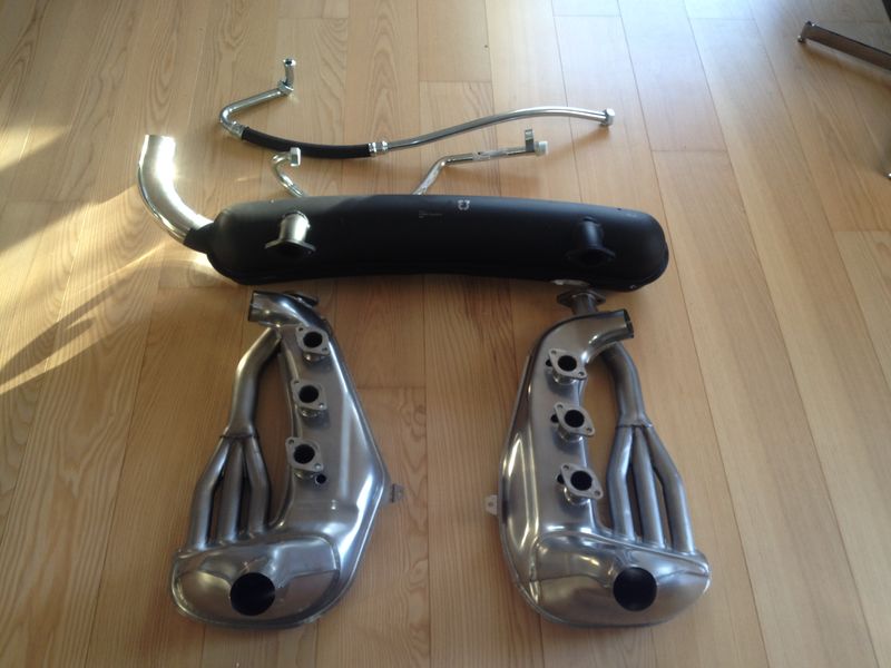

I was considering a complete conversion kit from Dansk, 1620000310
The link may be a little more local for you to check out
http://store.concept1.ca/Exhaust-Kit-911-2.7-3.0-1620000310/
But I think I'll go with individual heat exchangers and a dual tip exhaust
1623102570, 1623102580, 1620605800
Old 01-11-2018, 12:27 AM
Join Date: Apr 2012
Location: Edmonton
Posts: 415
Old 01-11-2018, 12:31 AM
Join Date: Apr 2012
Location: Edmonton
Posts: 415
I think the Type 1, 1620609100, would be the best option for a stock 3.0
