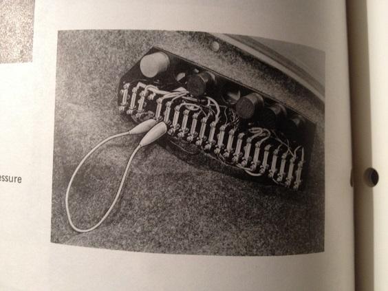

I have the same issue. Drove the car (1984 911) to work. In the evening would not fire. Battery is good. I did not smell fuel in engine compartment. On this forum, saw the below. Before I attempt: does anyone know do I turn key on? And how safe is it to short the bottom of terminals 6 and 5 as indicated below:
3. You can jumper a hot wire to the fuel pump and listen to it whir to prove that it's working. Run a short wire from the fuel pump fuse (#6) to an adjascent fuse (#5 or 7) at the bottom of the fuse terminal, the pump should whir. BTW my car didn't have the fuse info on the fuse cover (I think the old one broke), so Jim Bauman gave me his info from his '86 (#21 is closest to the front of the car):
proporsche 03-10-2018 01:17 AM
Hi..you fuel pump fuse is no 6 from the windshield.To test the fuel pump you do not have to have the key on...also do not run the pump too long.
If it is not running with this simple test.Either lift the front of the car and hit the protective metal in the middle The pump is right above it.Of course then you can check if you are getting any juice to it too....if it is not running....for that you have to remove the metal plate cover number 8mm Allen and 17 mm socket will do the trick.

Hello Proporsche Ivan. Before I shorted I put a meter across and measured 12V. I shorted and heard a buzzing sound. My guess it was the pump. Only held it less than 5s. Went to the engine compartment and still did not smell any fuel. However tried starting with no luck. SHould I have held the short longer? Appreciate in advonce for answer
