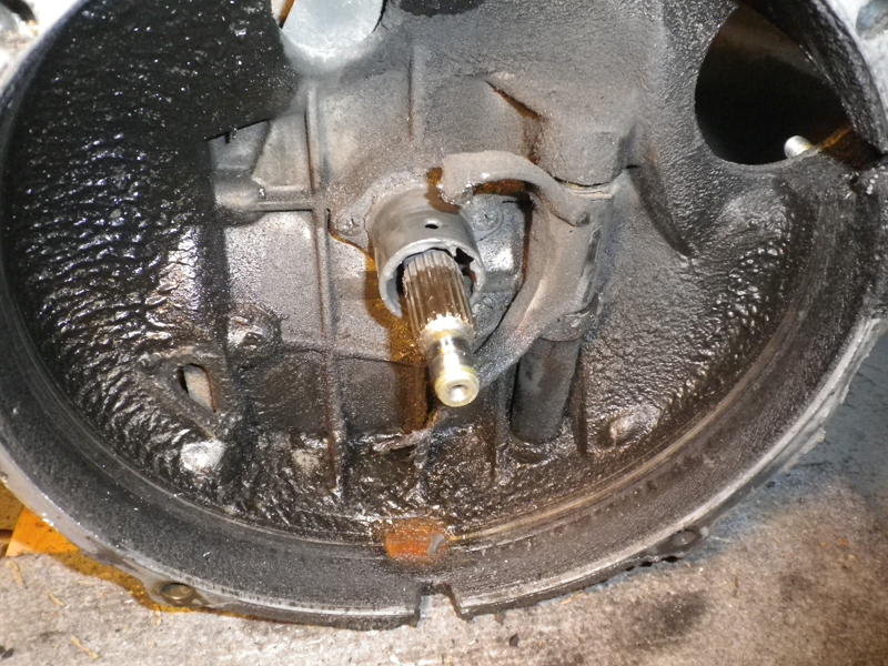

Old 03-24-2018, 11:21 AM
Join Date: Sep 2002
Location: NJ
Posts: 390
Fork is on the outside of the throw out bearing...

Old 03-24-2018, 11:25 AM
proporsche's Avatar
Join Date: Sep 2011
Location: Bohemia
Posts: 7,444
Hi Nut..it is good find...congrats but if you look at post 13 that is 40 post ago, there would have been an answer then for ya;-)
