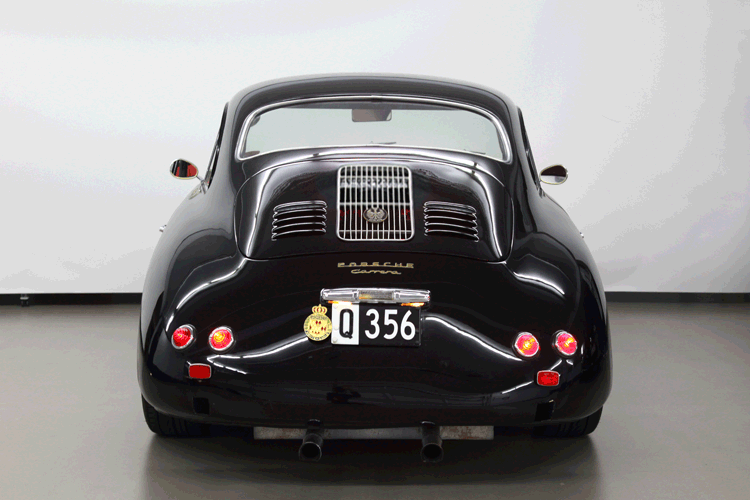

Now that the motor is back in line and healthy, I turned my attention to the lighting.
After a brief moment of panic as I feared being rear-ended at a stop light. I am adding a stealthy (.50" x 7") LED COB third tail light with flasher/brightness control module.
Waiting for parts to arrive then will post up pics for those who care to see it.
Also looking to retro mod my extra set of tail lights to accept LED panels for increased brightness as well, while maintaining stock appearance.

Here's the pic that inspired me to install a third brake light:
