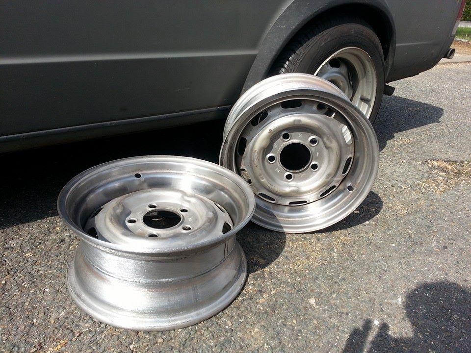

Join Date: Feb 2014
Posts: 67
Got the rims back today.
Now a set of Lemmerz dated 03/14 in 6x15 and 6,5x15
They've been dropped off at the powdercoaters and I'll be fitting test tyres on them next week

Old 03-29-2014, 12:58 AM
Join Date: Feb 2014
Posts: 67
This one has 7 rear 6 front (granted it's not a SWB, it has the extra wheel arch meat)
With 205 tires in the rear
I'm going to test fit a 165 R 15 I have left over (That I'll be using for the spare) on the 6,5 rim and see what happens (front and rear), although with all the info submitted here, I'm guessing 155 80 15 rear and 145 80 15 on front should fit thanks to the stretch incurred
this porsche 356 has a 5,5 rim with 165 R 15 tires and it's already nicely rounded so I'm guessing that pulling 155 on a 6,5 will clear the wheel arch nicely
The truck in the back of the photo of my rims is a VW sportruck with 8 inch rims. They clearly are outboard compared to the bodywork, but the tire fitted is stretched enough to clear the wheel arch
I'll see how it goes next week. And will keep the thread updated.

Where are you getting 6x15 7x15 steel wheels? Can't seem to find them and what is the cost? Thanks
Old 10-08-2014, 11:07 PM
Join Date: Sep 2007
Posts: 915
The rims were cut and then widen. Jeff Trask has had them done commercially.
