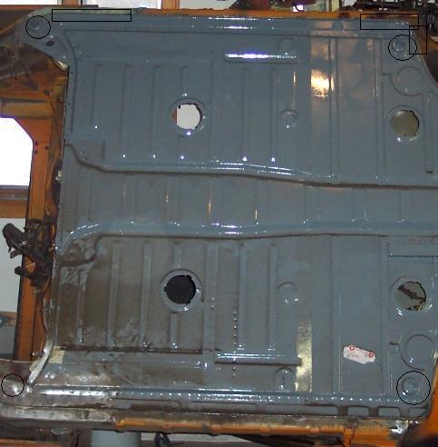

OK, here's a try at the "diagram with the areas circled".
The red areas are around where I would jack up the car. The front is toward the left of the picture, and you are looking up at the underbody. The front two circles are the forward torsion bar mounts, while the other four circles are around the "donuts".
The rounded rectangles are the seams that are somewhat stronger than just bare floor pan, and are where I would consider running a 2x4 to put the jack under.
I hope this makes it a bit clearer.

Thanks Dave, this will be going on the garage wall today

I couldn't open 74914's pictures but Dave, this is exactly the kind of thing I was looking for, most worthy of FAQ's and archives. Thanks so much!
