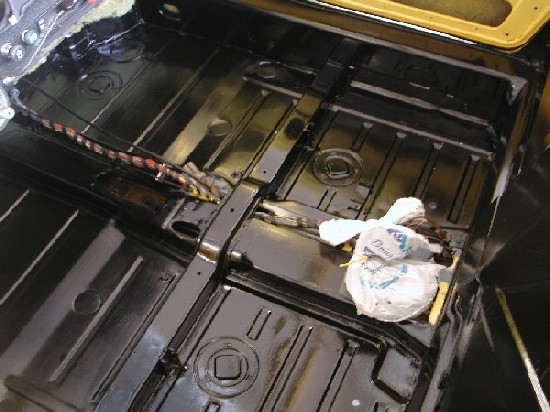

I had some surface rust on the floorpans underneath all that nasty tar...
Total time spent removing tar, grinding rust, and grinding away seam sealer on the floors and firewall = 40 hours.
Next. I applied Marine Clean and Metal Ready from POR = 1 afternoon (about 4 hours)
Finally a coat of POR-15 semi-gloss. It's still drying here, but it's so nice looking! = 1 hour.
I think this will be highly worth the effort for the final project.

From the pic it looks like you didn't grind through the factory
primer (grayish) in most places. I thought from a previous thread
that that would not let the POR-15 do it's best. That it should be in contact with the metal to prevent rust spread. Anyway that's how I did it recently.

The areas where there was surface rust, I wire brushed a decent amount away from the edge of the rust to the clean factory primer. I ground away all the seam sealer.
That factory primer is bonded there pretty friggin tough. I also don't plan on getting this car wet any time soon, so I'm not too worried about further rust.

Just type in "POR-15" on your browser and it should be one of the first on the list. As far as rust removal goes, "POR" is short for "Paint Over Rust", so all you really need to do is knock off the big stuff and brush/spray it on. What really amazes me about the stuff is that even brushed on, it looks like it was sprayed leaving almost 'Nil' brush marks. Also, if the metal is prepped correctly, POR-15 is tough as nails!

http://por-15.com/ About $31.00 a quart, I always brush it on, it hardly leaves any brush strokes. I would be afraid to put it in my good gun, because it dries so hard and fast you could ruin your gun if you did not clean it quickly after use with thier special thinner! I've used a lot of their other products, it all seems to be quality stuff!

Less than 1 quart.
