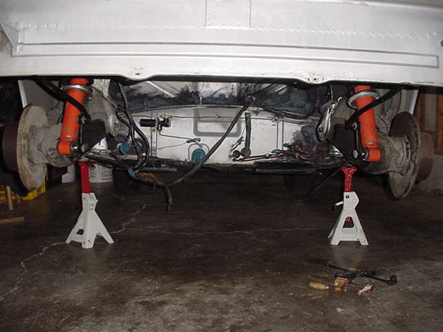

Kevin Powers 05-06-2003 05:11 AM
thought these pictures were timely for this thread. black is marhyde. i start with self etching primer today. local auto body supply matched paint # for silver final coat. lines/cables were shot/ questionable and i knew i would replace them. nipped them off with bolt cutters before engine drop, way easy. note how wide open the eng bay is with calbes and axels removed. more to follow as things more forward.

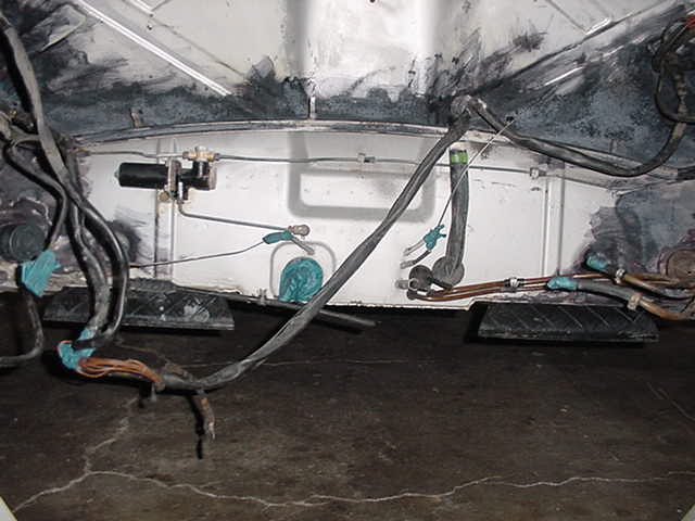

Kevin Powers 05-06-2003 05:13 AM
firewall.http://forums.pelicanparts.com/uploa... fire wall.JPG
Kevin Powers 05-06-2003 05:17 AM
wide open bay. note the konis with progressive coils that came on the white wreck. sway bar/droplinks painted and bushings replaced. soak the bushings in HOT water for 5 min and they go in very easy.
