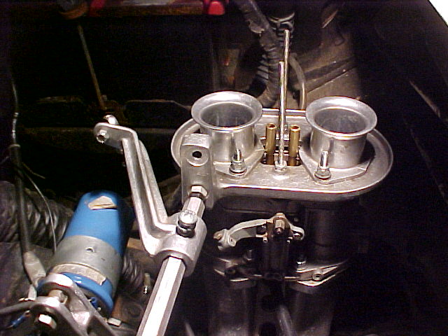

Okay- Anyone know dellorto's really well?
Its a couple weeks later and I recieved the 40mm DRLA's I bought from ALFA whatever via e*&y...
I'm guessing these are Fairly old carbs in pretty good shape.
I gave them a quick once over and bolted them on.
Started easily, lots of smoke, and backfiring.
I warm it up, and start adjusting.
It revs smooth, idles...so/so. All injector nozzles work great.
But it sounds like a 917 K30 when you 1/4-full throttle it.
Like raw gas out the exhaust and backfires rapidly, loudly, and continuously. Car jerks and power is on/off.
No amount of adjusting in several hours yielded much better results.
**?Carbs came with block off plates for the little lever on the side of each carb. One was installed. I havent ever seen this lever before, it actuates a small piston inside the carb, and is spring loaded. Piston moves up/down and sort of "chokes" the carb.
Any advice on these things...block off or no?

And what about the piston? I forgot to mention the linkage for it has a barrel/pinch nut where a cable should hook to it.
I can delete the linkage with the block offs and leave the piston in with the spring above is pushing 'down'. Then it doesnt move.
Or remove the piston all together...I may have to try both.
back to the garage..

No NO NO....pssh..
Not the accelerator pump. Both accelerator pumps are great, injector nozzles clear, good stream.
On the other side of the carb (both carbs) theres an arm that a cable can hook to, the arm 'rotates' and actuates a piston that moves up under tension...at rest it is in the down position.
When the car is runing, and the piston is moved 'up', it sounds like it opens a duct or vent...VERY loud suction noise, and RPM increases.
How do you post a picture..? I could show you the arm/linkage.
And even inside the carb where the piston is.
Another hint maybe?- Idle is smoothest, with all mixture screws turned all the way in.
I'll work on it some more...But I think it has something to do with that piston. It should probably be blocked off/removed all together and the bore plugged...I dunno.
Thanks for you help though, we'll figger it out.
Robert O
Hows this:

Thats basically the thing on both carbs.
A cable would go through the end and hook to the brass fitting in the center- pulling (on this side, pushing on the driver side)
actuates the piston.
??? Eh?

If the mixture controls idle best all the way in. The idles are rich. Go down a size or trim it till it ppurrs at one turn out the best.
The vents will cause some major isues with the set up you have. the 34mm vent changes alll the jetting, so do that first, and the jets may be okay in the idles..
can you take a pic of your emulsions? No Fiat carb I have ever seen has had the correct emulsions, before being converted. I can tell by looking at them.
I used to buy these carbs from wrecking yards in the UK, rebuild them, convert them, and sell them. I have rebuilt 65 in one week before!
The port omn the side is for an enrichment system. Retain it and hook them to a cableor electronic solenioid for a choke on cold mornings. Or remove it and block it off with a piece of aluminum. They can also be left in place and not harm anything. if these are sticking they can cause rich running in the midrange, or basically all the time.. Check them.
These are good carbs, but the Fiat models are different, and always need converting for our engines.

When you say block it off (makes the most sense) do I leave the piston in there? Or remove it all together?

Thanks for your help though, I've had the carbs off again, and thoroughly checked them, and have disabled the 'enrichment' piston doodad in a big way. It sacts like it dumping fuel yet the plugs read a little lean. Mixture adjustment does almost nothing.
The way it is the car is undrivable, it's that bad- it doesnt just miss, or backfire...it really cant be driven- ANY throttle causes repeated backfiring both through exhaust and carbs. Sound like mismatched mains/veturis?
