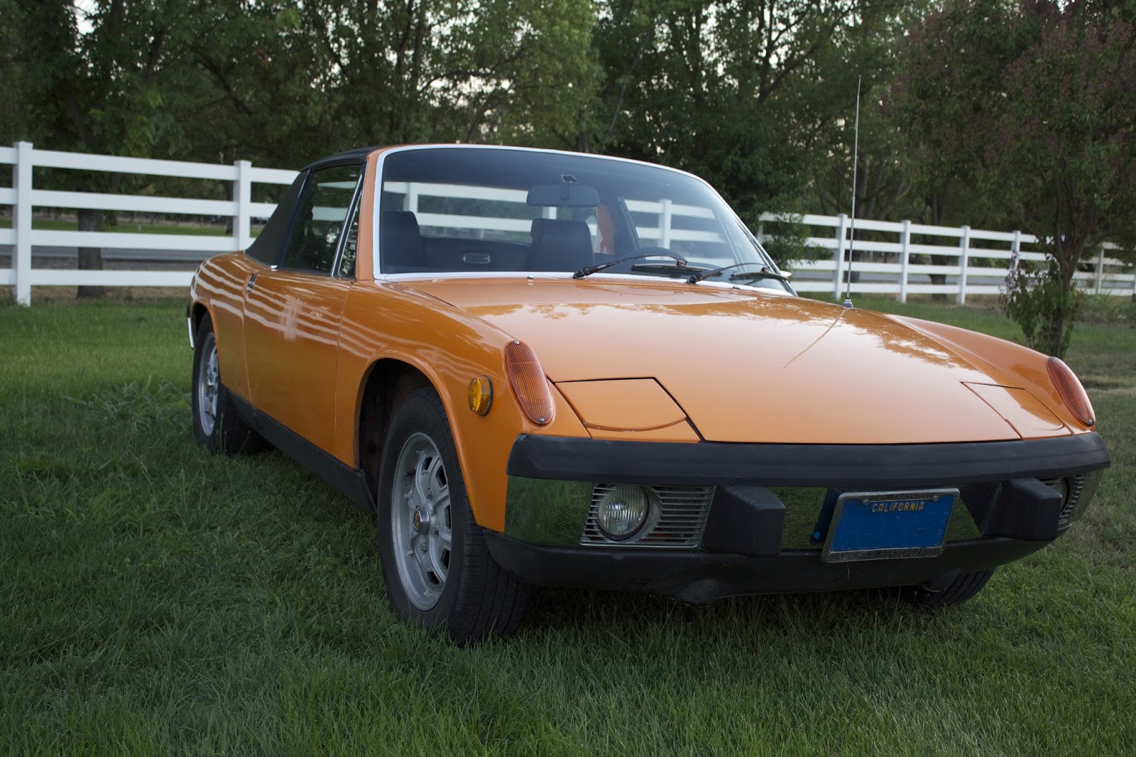

onegreenev 08-14-2013 10:03 AM
Low Idle
Newly acquired 73 914 1.7 and I had to replace the distributor vacuum line to get it to start. The fuel is old but still starts pretty well. Idle came up a bit after driving it a little but now the idle is low when the car warms up and coming off idle its sluggish but once off idle it runs great. Not sure if its other vacuum lines or not but I do plan on changing all the rubber I can in the engine compartment. It is still fuel injection.
Ideas? If you need more information let me know.
