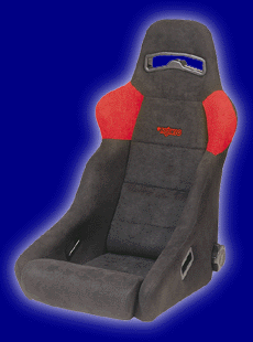

A lot of it is just personal preference and budget.
One additional factor is that I would limit my search to FIA approved seats. Regardless of whether it really buys you anything safety wise (although it probably does), it definitely is advantageous from a track event rules/inpection standpoint.

Another factor to consider is width. Depending on if you want your backbad installed or not. Many aftermarket seats will not fit within the confines of the backpad.
Also, some seats have problems with the emergency brake handle or the center cushion/storage tray clearance.
And make sure you figure out how you will mount it.
Just some things to consider in my research.
I'm about to buy a set of Koenig SP700 seats from Stable Energies. I've been told they fit fairly well, and can be mounted to the stock rails... I will choose, however, to buy their mounting brackets.

These Cobra seats are quite nice actually.
I think they are the most budget-friendly full-shell seats I've seen.
And they are FIA approved...
These seats have side-mounts and if you want to keep them on a slider, some fabrication will be needed as well as some ingenuity (that crossbeam can get in the way)
Cobra is often seen in ricers, but those are not the seats Kevin is looking at
Little advice: don't buy your seats post-order. Go to an actual store and sit in 'em so you can see which seat fits you best and most comfortable.

There are several POC guys running the Cobra seat, although I don't know which model. I think it's a quality piece.
One of the most popular seats out there, from what I have seen, is probably the Sparco Pro2000. Not sure if it fits well in the 914 though. You are right that anything over 18" wide IIRC would be pushing it.
I have a gutted-interior 73 down in the garage, with an older Konig P700 installed at the moment, in case you need any measurements.
BTW if lowest possible cost is not an issue, I completely agree about staying away from the tube-frame entry level seats. A full f/g or carbon/kevlar shell seat is far superior. I know the alum shell seats have a lot of fans, but most of them are not FIA certified (?) so I think you'd have to run a seat back brace.
Last thing, I think you'd be saving yourself a lot of potential headaches and fab work if you focus on bottom-mount seats. There are certain seats designed for side mount, some bottom mount, a few can go both ways.
Ok, really the last thing, FWIW I have done biz w/ Sube Sports and been 100% satisfied. YMMV of course. No vendor is perfect. One of our favorite "near-perfect" P-car parts vendors is reputed to source its seats and safety/race parts from Sube, by the way.
Keep us posted what you decide - I'm gonna be in the market too, in a few months.

No e-brake or tunnel interference issues with those Forza's or the Konigs I have now. Tight fit, but no probs.
I was using completely stock base & mounting geometry. If you do a custom/aftermarket mount, you can angle or move the seat slightly so it is closer to 'centered' compared to the steering column.

I just measured the available width
The distance between the center tunnel and the inner long is 20"
(50 cm actually)
You need a little under 2" (4 cm) clearance for the parking brake, so that leaves you with about 18" of workable space...

Be smart, don't waste your time and money on tubular frame seats (even if they are FIA approved)

I bought the Forza seats off of a guy on the 911 board. I only bought these because of the price... never used and 2 for one sale. They are no means as comfortable as the Sparcos that I wanted but I couldn't pass up the bargan price.
Having been in a Sparco Evo II, I wish I could afford these. That said, I believe you would loose the E Brake function if they could be mounted at all. For all track use, get a tight seat as it'll hold you in place better with less fatigue. For combo street/ track, find the best compromise based on where you'll drive the car more.

I like the fit of them for my build (I'm a bit slim at the waist) and you can order an adapter designed for the 914 that mounts the original seat rail to the seat. I also like the fact that they are available in a black vinyl version that hopefully will complement the rest of the interior (just geting the one seat for now.)
By calling Jim Husten directly at 888 504-0280 I got the seat and adapter shipped to my door for $234.00! I like the sound of that!
The price is the best that I have found and if the result is a good one, I'll shout it from the rooftops.
Now, the question is (though I have already made the purchase) what, specifically, is the argument against a tube frame seat? And is the argument germain to a vehicle that will see limited track time, mostly AX, DE, TT and possibly POC Small Track?
Herb

I believe the argument is that the tube frame seats (particularly the middle springs) aren't that comfortable. If you sit in a solid 'glass or metal seat then in the tube frame, you'll really see the difference. Like you said, the price is hard to pass up.
