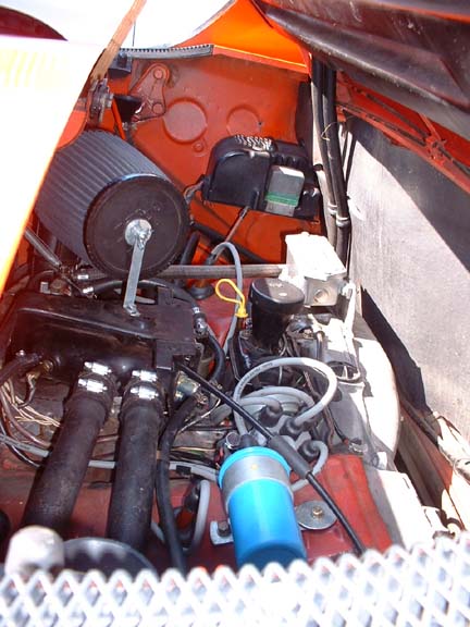

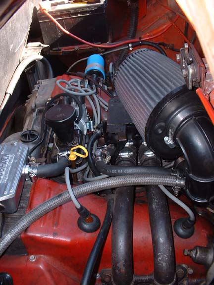

Porsche Crest This is what I did
For my 1.7 I found a K&N (RU-3610) and trimmed the stock U-tube. I drilled a small hole in the end and attached it with a wing nut to a piece of small strap that attaches to the original screw hole where the airbix once went.
Cost me $35
Herb

Chris,
here is what we found on the chassis dyno:
Stock 2.0 filter housing with K+N air cleaner (98hp at the rear wheels)
Nothing on the 2.0 throttle body (100hp at the rear wheels)
Is that "thing" really worth the 2hp (maybe)
We moved the snorkel around to point towards the relay board and picked up 2lb feet of torque (whoo hoo)
(my vote: worthless) leave it for the rice crowd. The first time it rains.. you'll be real surprised.
Oh.. if you do decide to go this route.. look at Meeders pic very closely. What most people dont say in these "air cleaner threads" is how important it is to pull a vaccuum on the crankcase. This keeps the engine from spewing oil out every possible seal. Meeder has all his breather lines going into a CB performance "catch" then one line going to his rubber elbow that connects to his throttle body. So.. the people you gave us the link for actually have a correct solution. The breather lines is what most people "blow off" no pun intended, then then dont understand while the valve covers leak and the push rod tube seals leak.

Porsche Crest Really?
I had heard the argument that you generally don't want the crankcase to vent into the intake. You are basically dumping vaporized oil into the intake, which effects the efficiency of the burn. The major reason that the crank was vented into the air box was for clean air reasons (they didn't want vaporized oil venting straight to the atmosphere.) I installed the vent box (on the left in the upper photo) to relieve crankcase pressure. I had previously had the case venting to the "U" tube (like that aftermarket unit does) and the vacuum pressure was sucking oil out of the case and into the intake! Everytime I pulled the intake apart the inside was coated with oil! I could only imagine what this was doing inside the motor. I suspected fouling. At least the stock airbox has the crankcase ventilation entering before the air filter, providing some particulate filtration. That aftermarket elbow provides no filtration, and this caused me great concern. Also, the stock upper vent tubing enters the airbox where there is far less vacuum pressure (most comes through the air intake) than directly in front of the throttle body like that aftermarket unit.
The crank vent box on the left allows the case to vent to atmospheric pressure (you can't see it but the lid is vented under the lip) and has a sponge filter that captures most of the oil particles and allows the oil to condense and eventually drain back into the case. Being a 1.7 there are no vents on the heads, but I will be adding them soon (I have a set of valve covers that have vent tubes. These will also run up to that vent box.) This is a system used on many, many dune buggys and performance bugs and I did some amount of research with some guys who build performance VW motors. Many use this crankcase venting system.
You will also notice that there are 2 tubes that go to the elbow. The fabric covered one in the foreground is for the gas vapor recovery from the gas tank and the one just behind that goes to the AAR.
BTW, I have no leaks at pushrod tubes or valve covers. I am very happy with the setup.
The other major benefit of the K&N is that it eliminates the huge air box that makes it so difiicult to work on the motor. I use to always have to pull the box off to get at the rest of the motor. Now, I rarely have to move it and as you can see from the photos, there's lots of elbow room in there now!
Herb

Herb,
everything you mentioned is correct about pulling oil into the engine. Take a look around at all the PRO drag racers and notice that they have a vacuum pump pulling 14 inches of vaccuum on the crankcase breathers. This frees up HP. Most of them use one port from their dry sump setups to pull this vacuum others use a belt driven sunction pump thet they use to pull on the engine.
I think your oil in the intake problem was because the oil "catch" was mounted too low and it allowed the oil to accumulate in the "catch" and therefore be sucked into the intake.
I totally agree about the space issue... but we dont really work on our engines after they have been tuned (no reason to really remove the air cleaner...luckily)
The 4cyl engine horizontally opposed creates a ton of moving air inside the engine.
B
