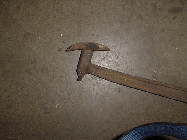

If it stops raining this weekend, I hope to install my new engine mount bar. (Thanks to eveyone who helped me diagnose that I had the tail-mount version.) But, before I do, I have a dumb question. Which way do I mount the solid body mounts? A little while back, Kevin Powers posted this photo:
Is this correct? The body mount looks upside down to me. It seems that the curved part should point toward the ground?

Nope, the pic is correct. The mount should sit up on the top side of the "pod" that the whole setup bolts to on the chassis. The flat part should be downward, sitting on the lip of the pod.

Oh! Thanks, Dave. Now I get it.
