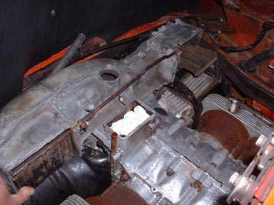

Hello All,
Does anyone have pictures of the cooling flaps without the shroud on the engine? I really don't want to break down my car to take the sheet metal off to see how it works.
I am mostly interested in pictures of the passenger side. Basically I am interested in how the flap works, looks like when the engine cool, and looks like when hot. As well differnet angles would be nice. As close as possible to a side view or front/side view looking towards the tranny.
I am certain mine are fine, but just for the life of me, cannot imagine how they work from the descriptions and limited pictures I have found. This is bugging me for some silly reason. Someone must have an engine out being worked on and a digital camera?

This is all good, and I get that part... What I really would like to know is what is the shape the the flaps and what poistion are they in for each state. This wold then let me undestand where the airflow is going and being directed to, as well as what it looks like inside the tin where this dance is going on.
I mean how can the passenger flap (When its cold) be pulled upwards to the tin and make it so air is not going into the Oil cooler? Is air passing just above the cooler and not going in (Though nothing is beween/blocking the air and the cooler) until the flap is lowered?
When hot is the air directed into the cooler by the flap being lower, thus the cooler is not actually cut off directly from airflow when cold, but because of the flaps air just does not go there. Maybe some air does go there... This is what I would love to know.
I know it is probably really simple and easy, but untill I see it I am loosing sleep over it.

The passenger's side flap works opposite the way you think it would. This is in great part because it pivots near, but not at the bottom of the flap.
When the flap is "closed", the bottom part goes down to cover the opening to the oil cooler, and the top goes up to block (at least partly) the air going to the cylinders and head. When the flap is "open", the bottom of the flap comes upwards. It comes up far enough to serve as a splitter and direct some of the fan's air down into the cooler. The top part flops down far enough to (mostly) get out of the way of the air going to the cylinders and head.
I hope the description is of some help...

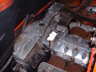

I just so happened to be futzing with the flaps earlier this afternoon. I'd hate to have insomniacs walking the streets like the undead so I took a couple of shots. If you have to know what it looks like, this first one is what they look like when the car is cold. Normally the tension provided by my thumb would be provided by the bellows, cold and contracted to its shortest.
Now close your eyes and put imaginary tin over the motor. In the upper image the flap on the drivers side is closed off to prevent airflow over the cylinders. The passenger's side directs the airflow away from the oil cooler. In this position the car warms up most quickly.
As the car warms up, the bellows elongate and the flaps rotate into the second position. In the lower image the driver's side flap now directs aiflow over the cylinders and the passenger side splits airflow between the cylinders and the oil cooler. This provides the most cooling.

Brilliant Herb, Thanks!!
For some silly reason I originally thought it attached and pivoted at the Tranny end and not the impeller end of the flap. This is what was making my mind go nuts because I could not figure any way for that to work. But who knows with those crazy German engineers. They can make anything work!
