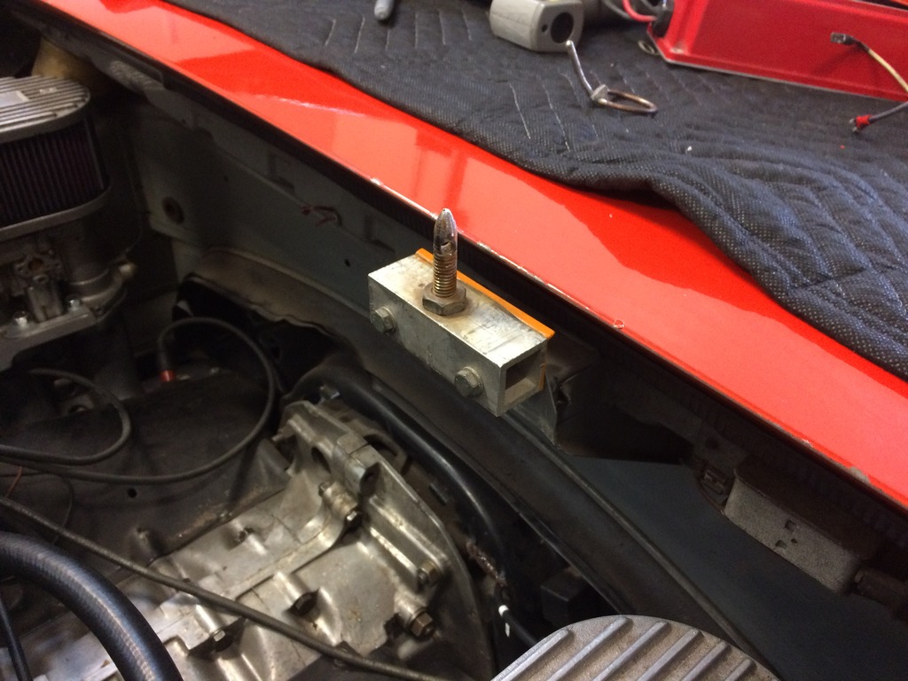

I installed a similar engine lid since the 74 911 2.7 motor install. I cannot use the original bonnet latch because of the CIS boot. Do you guys have any solution for latching the engine lid, I will consider all options. Thanks.

Hood pin.

Yup, that's what I did on the race car. Mount a tab into the rear firewall somewhere along the aft edge of the rear lid, and put a vertical pin on it. Clip it and done.

A couple of hood pins works well and is simple. Another option I have heard of is to reposition the latch on the other side of the engine lid, out of the way of the CIS boot, and use a longer cable.
I have also heard of people cutting the CIS boot and gluing it back together to clear the existing latch. Or people flipping the whole intake left-to-right, and bending up new hard fuel lines for the injectors to fit the new fuel distributor location.
Any pics of the install would be very helpful, thank you.

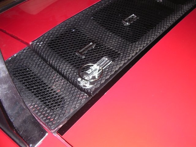

Here are some images of hood pins on a 914:

Thanks Dave...Thanks for sharing the pics! To be honest, I really do not like the appearance of the pin type locks. I was thinking along the lines of a 12V solenoid operated latches from underneath.

What happens if your battery goes flat? The early Boxster guys have had significant problems with that...

Excellent point DD.. back to the "save the manual"
