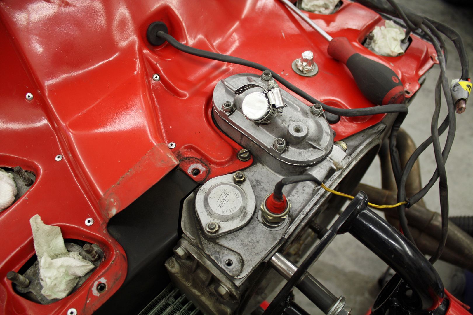

Perry built in an oil cooler box in the front trunk and mounted a collapsible spare vertically.

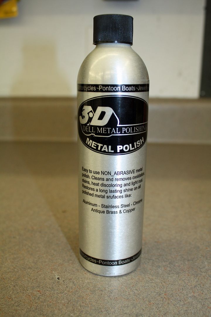

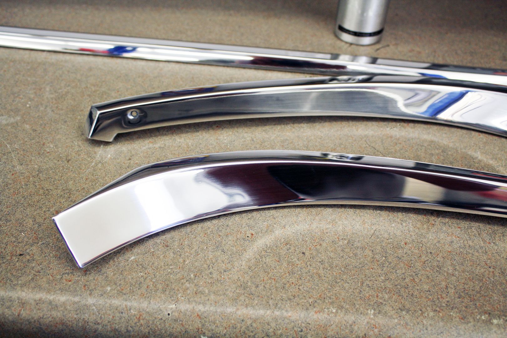

We are back from our five week motorhome trip and I am ready to get back to working on the car. As I had written previously, I had sent the sail panel trim away to have it refinished. The pieces were here when we returned and they look better than new. I didn't have really good "before" photos but you can get an idea of the improvement with these images. The left side short piece was in the worst condition.
For those of you who may have some interest, here is a link to his website: https://www.dellmetalpolishing.com/index2.html
He charged me $160 for all three pieces.

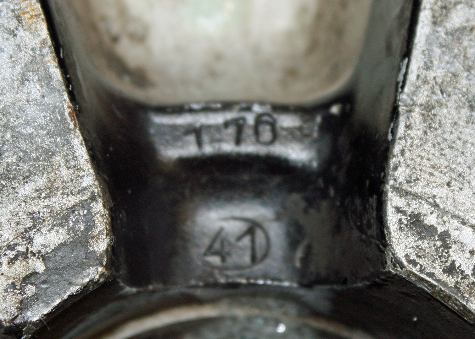

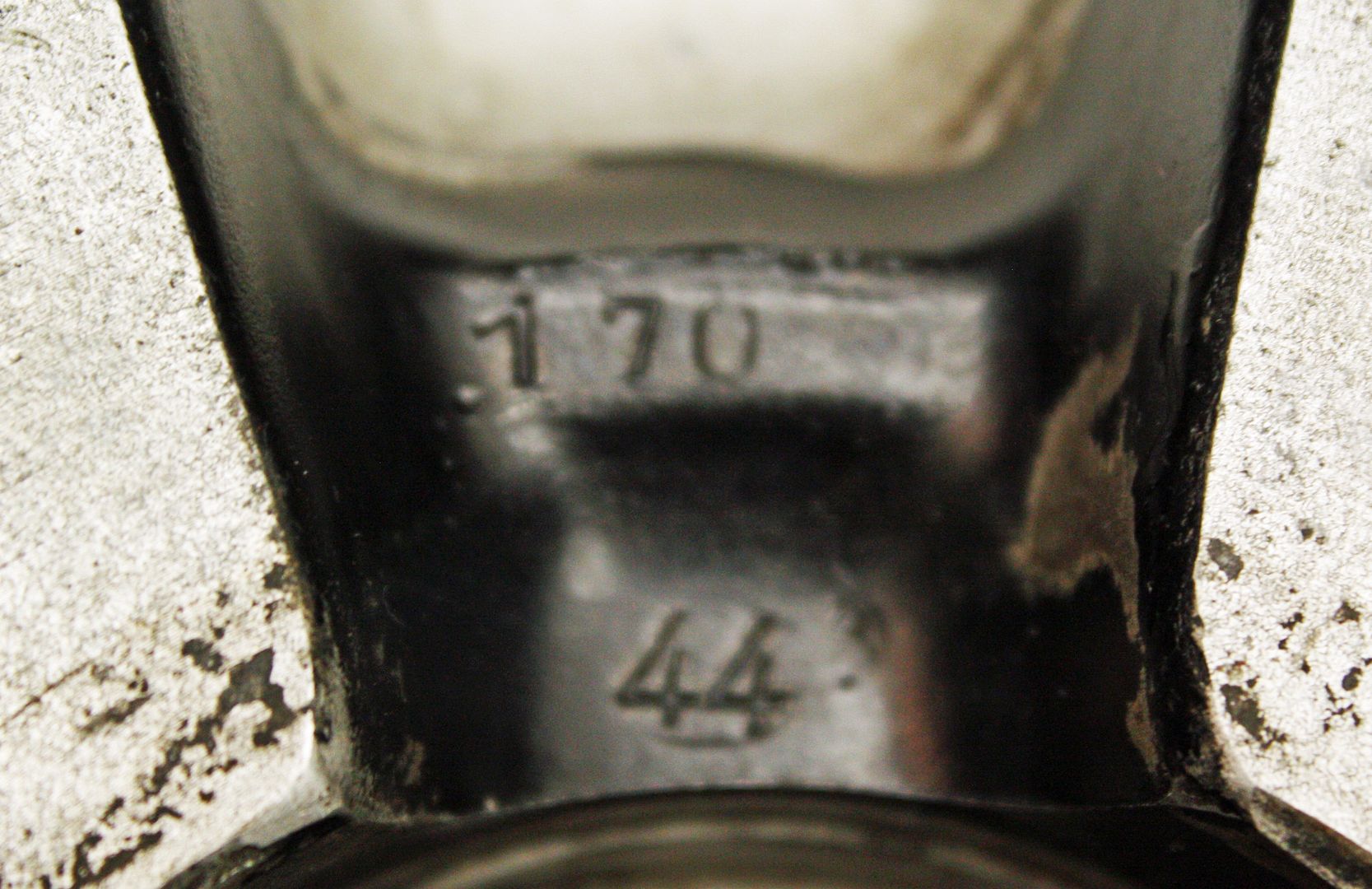

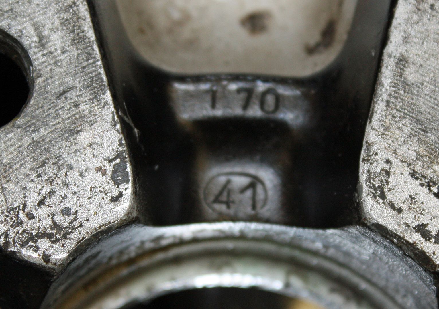

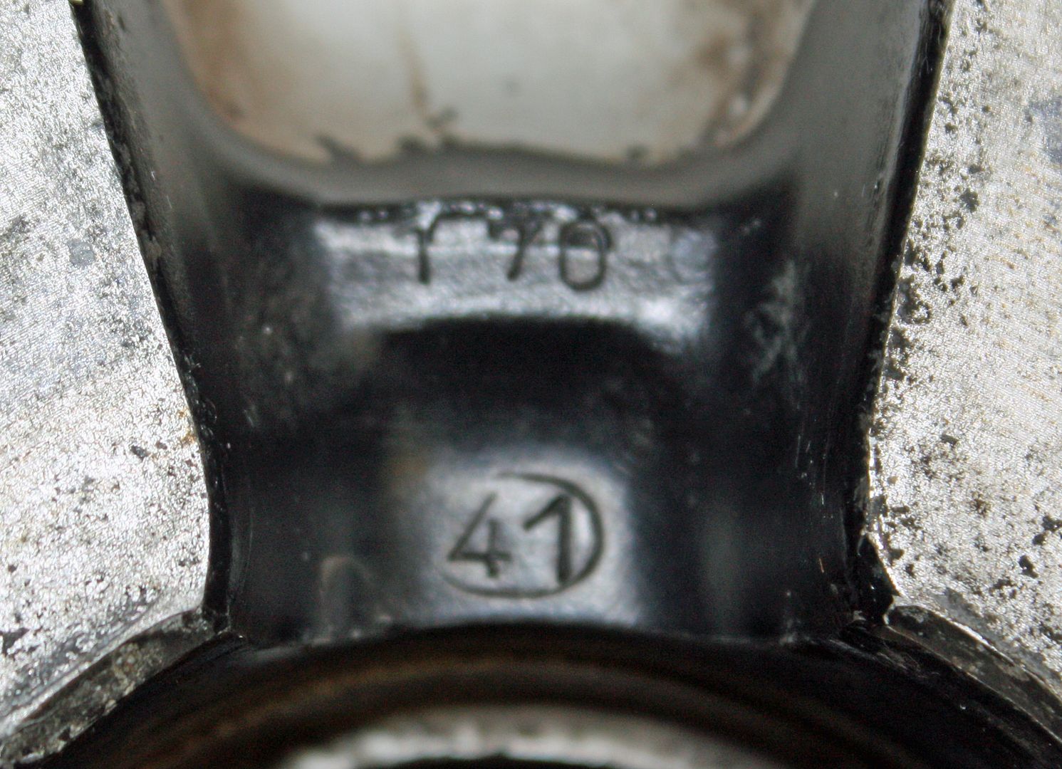

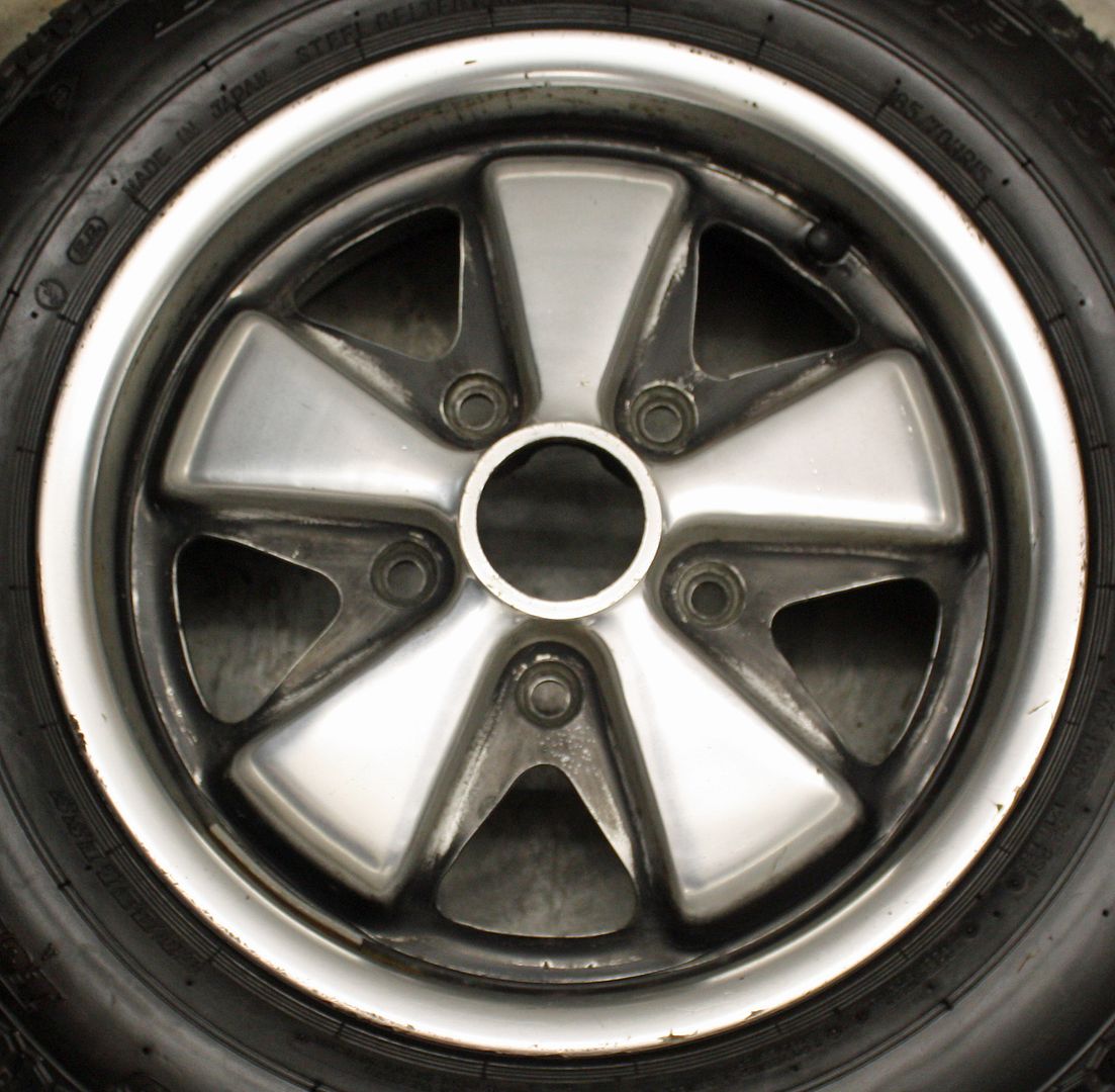

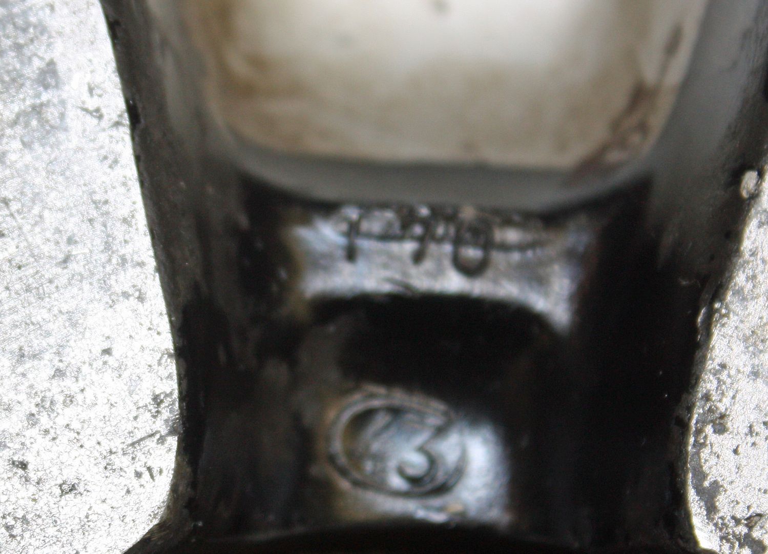

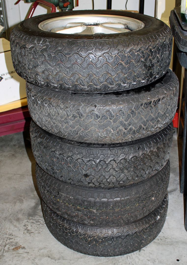

Part of the stash of parts that came with the car were five Fuch's 15x6 deep dish heart wheels. I cleaned them up today and am trying to determine the build date. I took this photo of one of the inside spokes but I don't know what to look for to determine the date. I would like to know as I will be selling these.

A person on another forum told me where to look for the wheel date. I couldn't go to bed until I looked at the dates. They are all 1-70. The tires appear to be from the eighties. The other wheels are in similar condition to the one pictured here. The finish appears to be original.

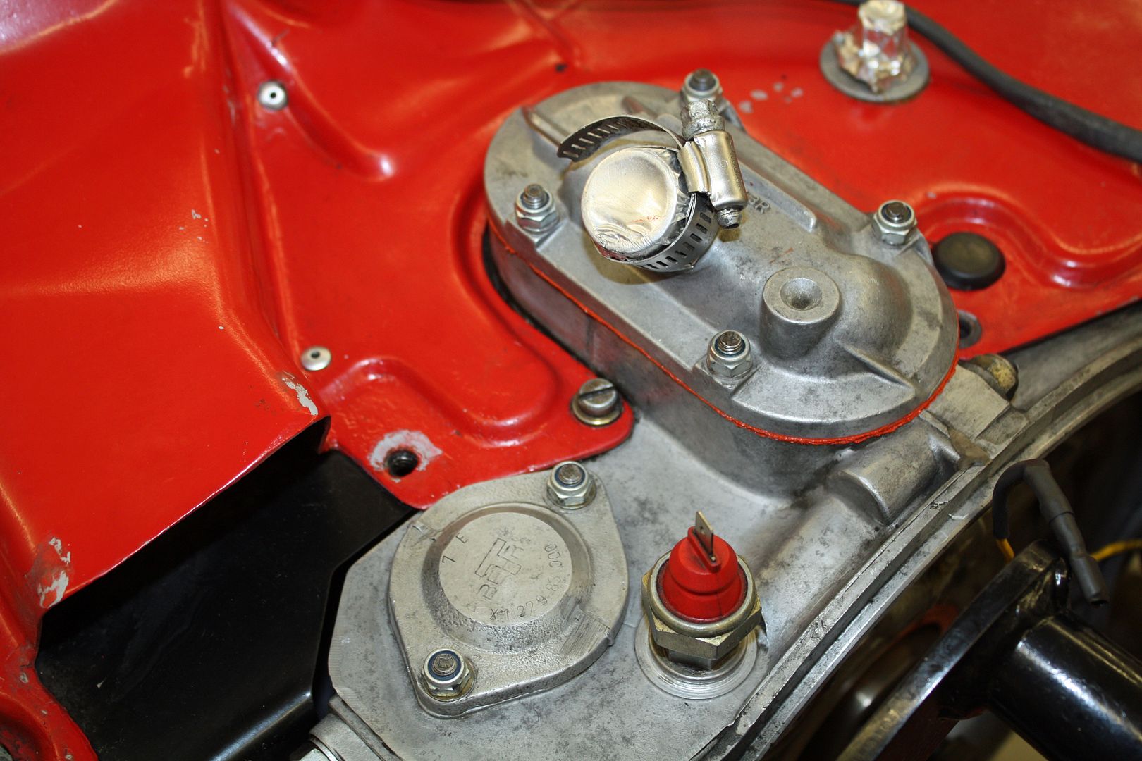

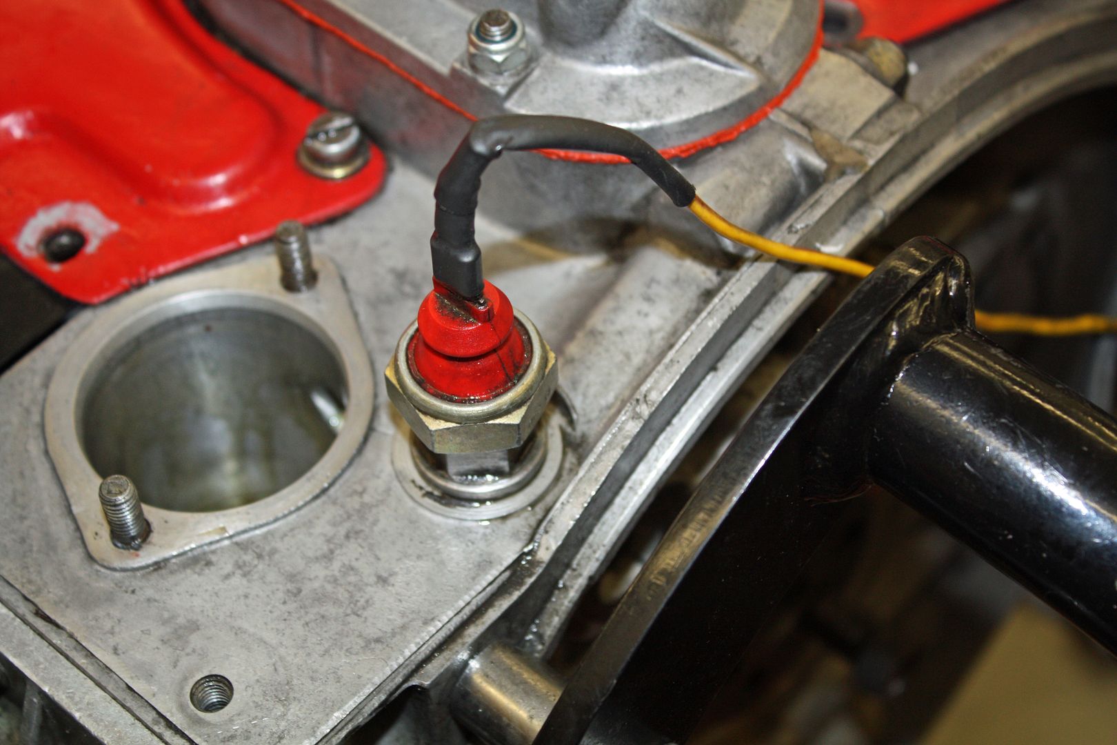

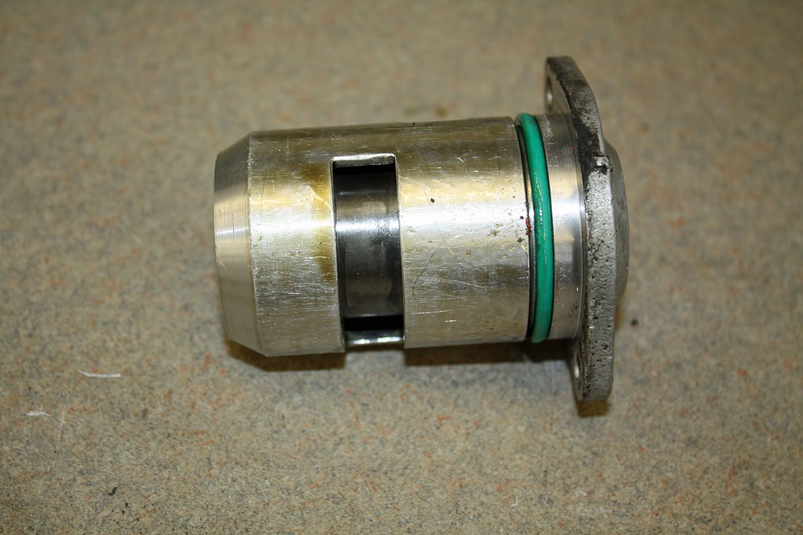

I finally found a few hours to spend on the engine today. At the rear of a 911 engine is the "Holy Trinity", a place where oil leaks commonly occur. The three items are the oil pressure sender, the oil thermostat, and the breather. Since these would be very difficult to get to once the motor is back in the car, I removed all of them and re-sealed them. Being a little pro-active here.
