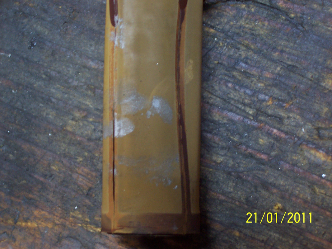

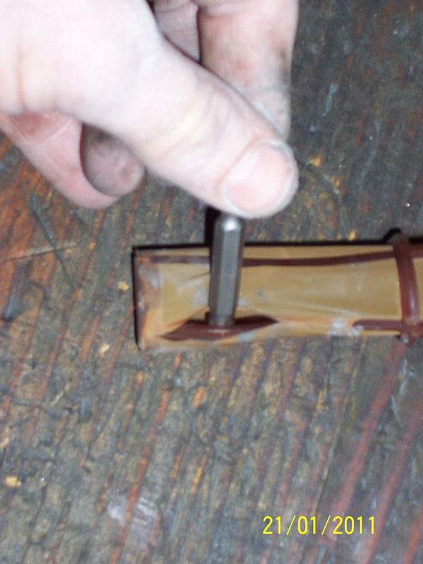

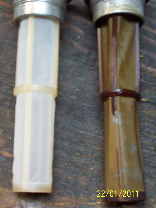

The in-tank strainer is likely bad, allowing sediment from the tank into your pump. Has happened to many people on here.

Sounds like you are down to the tank strainer then. I've never seen one that had failed and was passing chunks to the pump but it sounds like others have. As a test you could try an inline fuel filter before the pump but it might limit overall flow. A clear filter would tell the tale though.
Taking the tank strainer out can be difficult and in some cases people twist the whole tank insert out so be careful on that route.

Old 08-21-2019, 05:47 AM

Old 08-21-2019, 07:05 AM
Join Date: Oct 2002
Location: Boulder, CO
Posts: 798
Thanks for posting that pic KD. Maybe they get clogged and the fuel pump collapses them until they split. Interesting.
