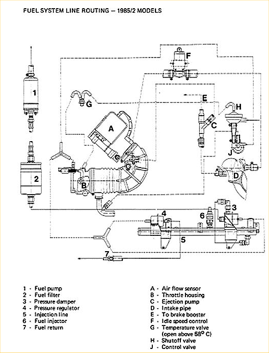

I am having a hard time with the vaccum routing of the big hoses. I took a bunch of stuff off weeks ago and did a lousy job of documenting where the vacuum hoses go.
For instance, where does the short hose from the idle speed control go? Clarks says the intake pipe. The hose is very short and won't reall reach. What attaches to under the intake manifold? Is that the hose that goes to the brake booster? How about the one that comes off the oil filler vent? I should have taken more photos.... :(

Diagrams for both the early and late engines have been posted here many times. Search. Also look for the fuel vent routings. Check your passenger side front fender well (above the windshield washer tank) for a diagram.
VaSteve 05-03-2006 07:20 AM
Yeah, I found the diagrams. I am having a hard time with the ISV. It has a kinky hose that comes off it that doesn't appear to attach to anything on the manifold. Under the manifold there is a place to attach a hose, but it didnt' appear that the kinked hose would reach. Are the early (84) manifolds different from the later (86) - aside from the screw for the cruise control cable. The tubing I'm trying to attach is from my 86 onto an 84 manifold.

Tom, that would be great. I may have just misoriented the hose when removing it, but if the manifold is inded different, I'll just reinstall my 86 manifold on this 84 engine. Would rather move one hose than 4 gaskets, 8 bolts, etc. :)
It appears that the ISV should hook up to the manifold "D", but like I said, I might have it out of whack. Plus I was tired....

SoCal Driver 05-03-2006 08:02 AM
You were advised to use the manifolds and ISV from the 83. As you have found the intake and ISV from the 86 is different. You will have to use the original manifolds and ISV just as you have to use the original fuel rail due to where the fuel lines run through the chassis and connect to the fuel rail.
There is no other sollution.

Ug. Looked at it closer tonight. Got the 86 manifold out of its storage spot. It *is* different. Wish I looked closer before posting. :rolleyes:
SoCal Driver 05-03-2006 08:22 PM
You're right. It was using the cam from the later engine.
But since the subject has been brought up; use the ISV, intake, AFS, fuel rail, from the 86 on the 84 engine. The 85.5 year break changed a few things on the engines besides the cam. Actually the 84 engines have the mounting brackets for the power steering where the 83's do not. You may want to change the drivers side engine-alternator-A/C mounding bracket too. Along with the poly rib pulley on the crank. The alternator on the later engines has a six rib pulley while the early engines have a five rib pulley on the crank. Also a 110 amp unit while the early is a 90 amp unit. If you have the cast iron headers use them instead of the welded headers. The welded tend to break when the engine mounts are shot.
