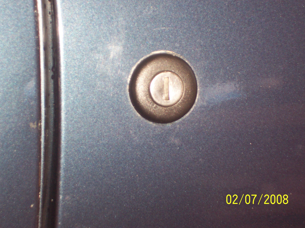

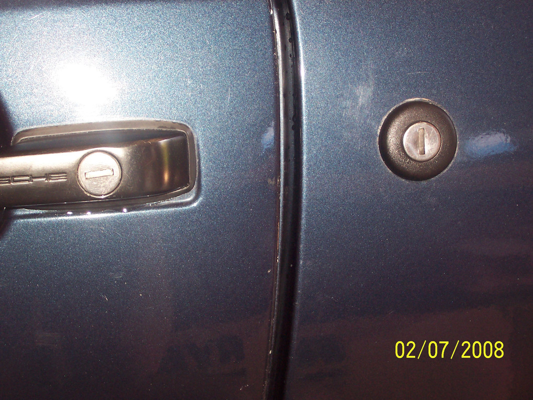

Since I didn't find a good "how to" with images on this topic, I decided to make my own.
For those of you who have a factory alarm (Option M533), but not the key for it, this is the procedure to make it so that your ignition key will work with the alarm.

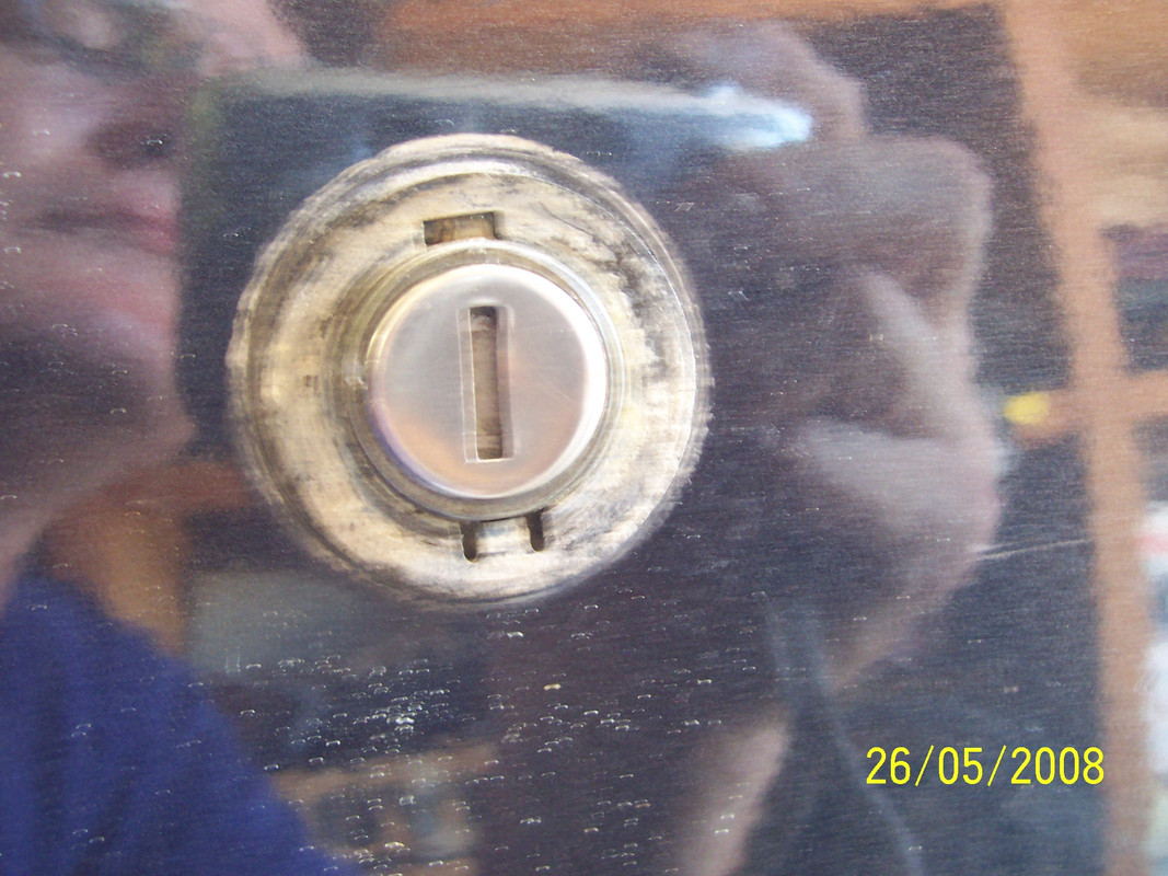

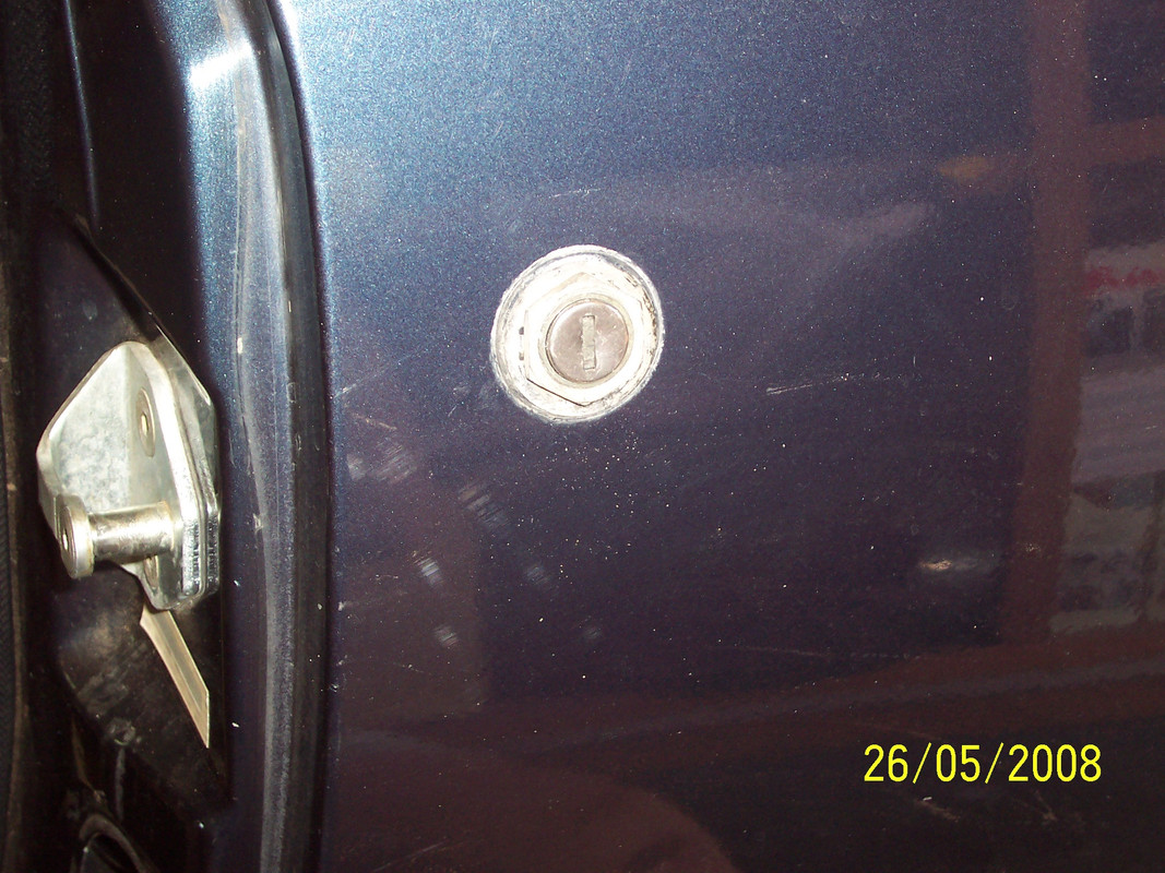

The factory alarm switch/key is located just behind the driver's side door lock, in the quarter panel. There is a plastic cover over the securing nut, which is very difficult to remove intact. I broke mine upon removal, and am looking for sources to replace it. It is simply snapped over the securing nut, and with very careful twiddling with a knife you might be able to get yours off intact:

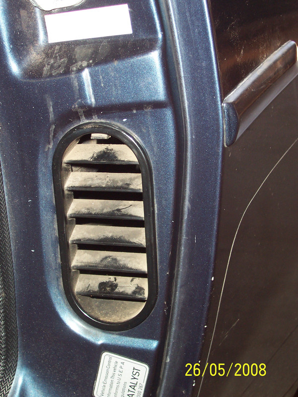

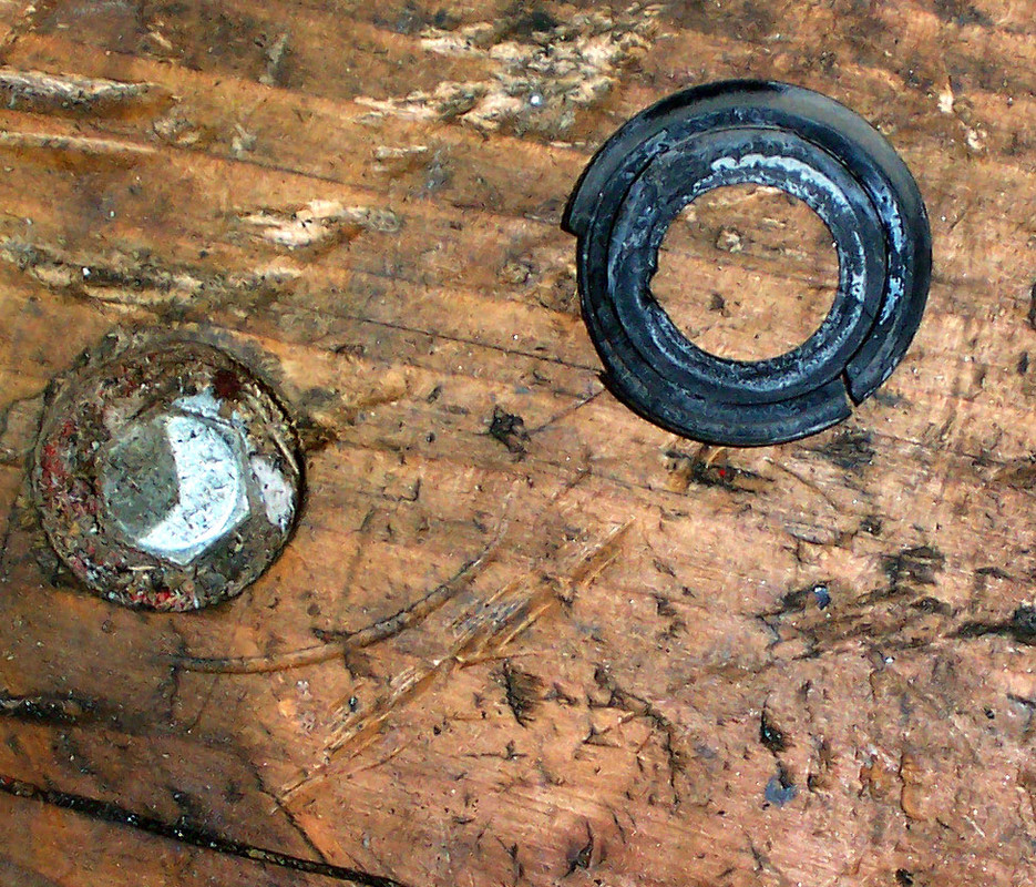

Once the cover is removed, you need to remove the vent cover in the quarter panel. There is a retainer (shown at the top of the vent in this picture) that you should carefully retract to get the cover out:

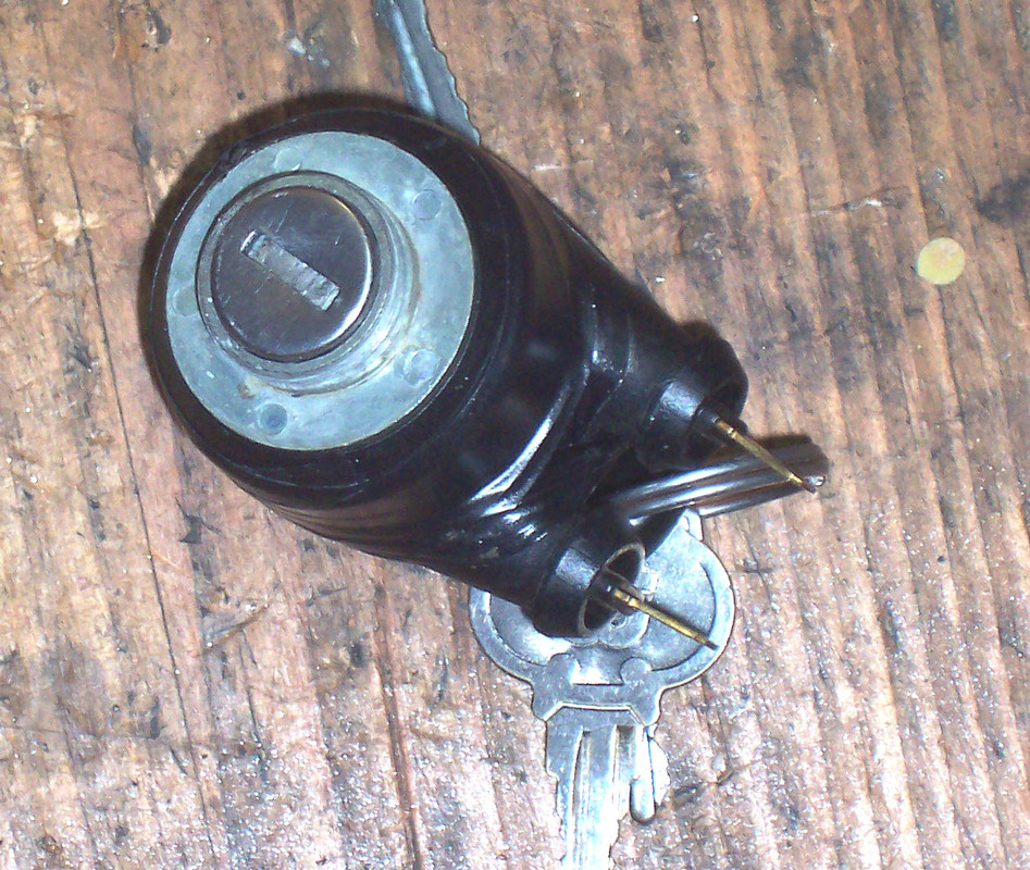

Now you can reach in the access hole and remove the switch/key assembly, after removing the exterior nut:

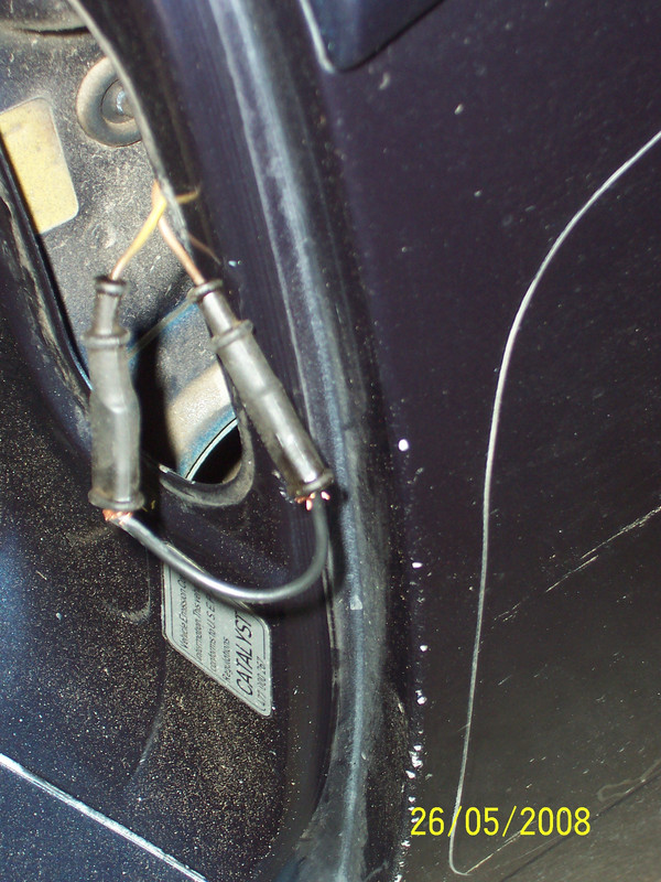

If you remove either of the wires with your battery connected, the alarm will go off. There are several ways of silencing this: 1) Disconnect the battery 2) Make a jumper wire and connect it across the wires or 3) Disconnect one wire for about 1 second, then touch it to the terminal on the switch for a moment:

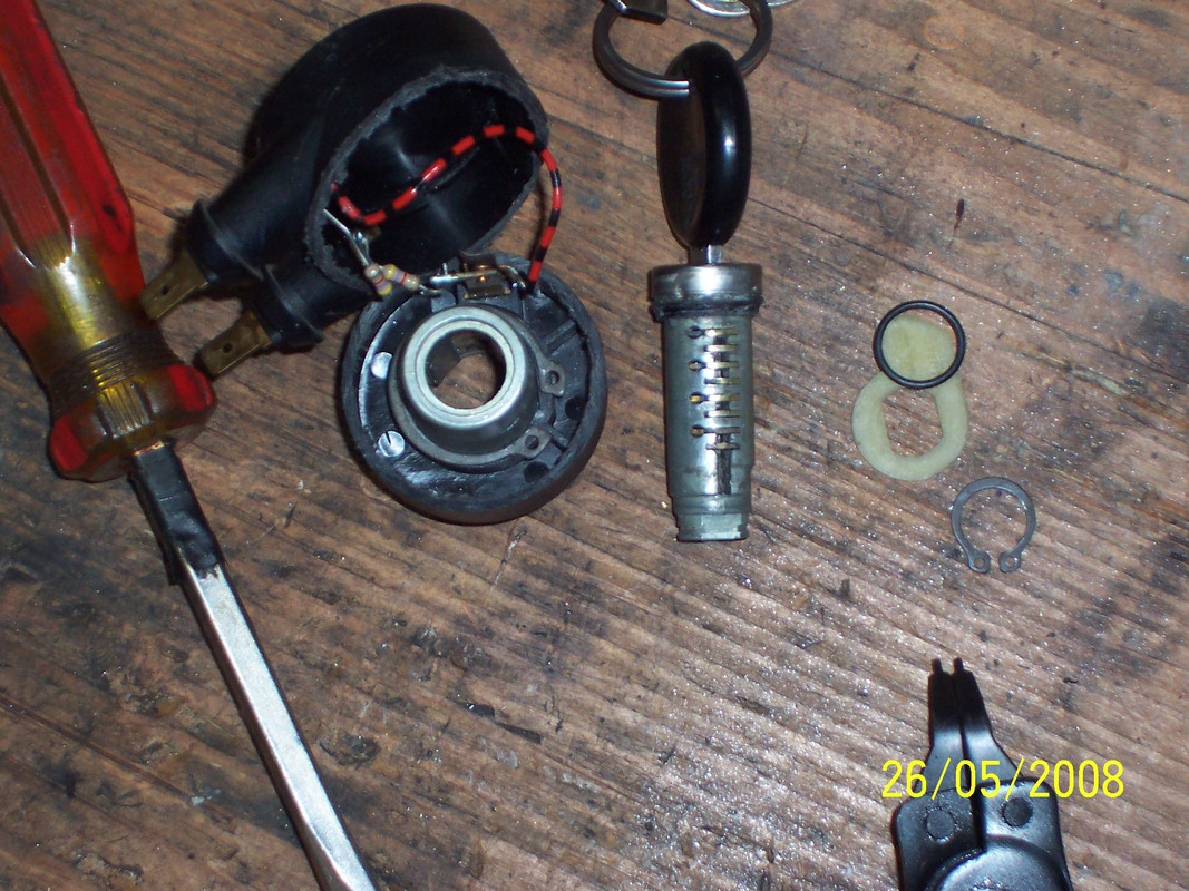

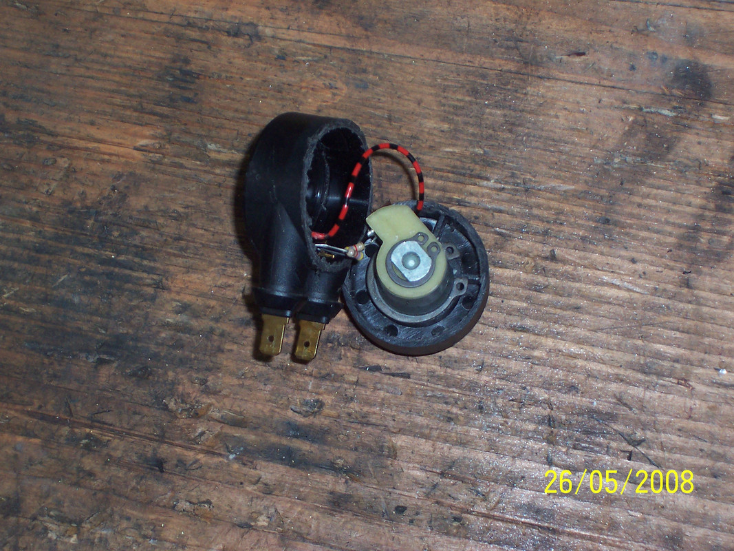

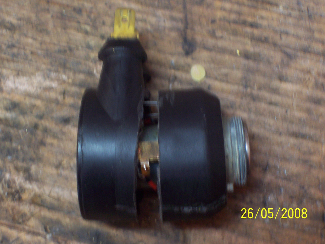

Okay, the switch is now out of the car. The next step is to cut the plastic case apart to get into the key. I used a hacksaw for this, carefully only cutting into the plastic case as there are contacts and such underneath. You might want to saw in a slightly different location:
Carefully separate the parts, and you can see the lock cylinder, contacts and resistors that make up the switch:

Note the location/orientation of the parts, and remove the retaining clip with a suitable tool. INSERT YOUR IGNITION KEY to prevent all of the lock cylinder springs and such from flying all over the place. Now, you can push with a Phillips screwdriver to drive the key cylinder out of the housing:
You now need to file down the high points of the tumblers so that the cylinder will turn smoothly in the housing. Once this is done, then carefully put the parts back together.
To hold the plastic case together, I simply wrapped it with electrical tape a bunch of times. Use some epoxy if you prefer.
Connect the switch back up with the wires, insert the assembly into the hole again, making sure to align the key correctly. The washer that goes on top also has a specific orientation that is keyed at the bottom:
Put the nut back on, tighten it up, replace the vent cover, admire your work and enjoy your functioning factory alarm!
