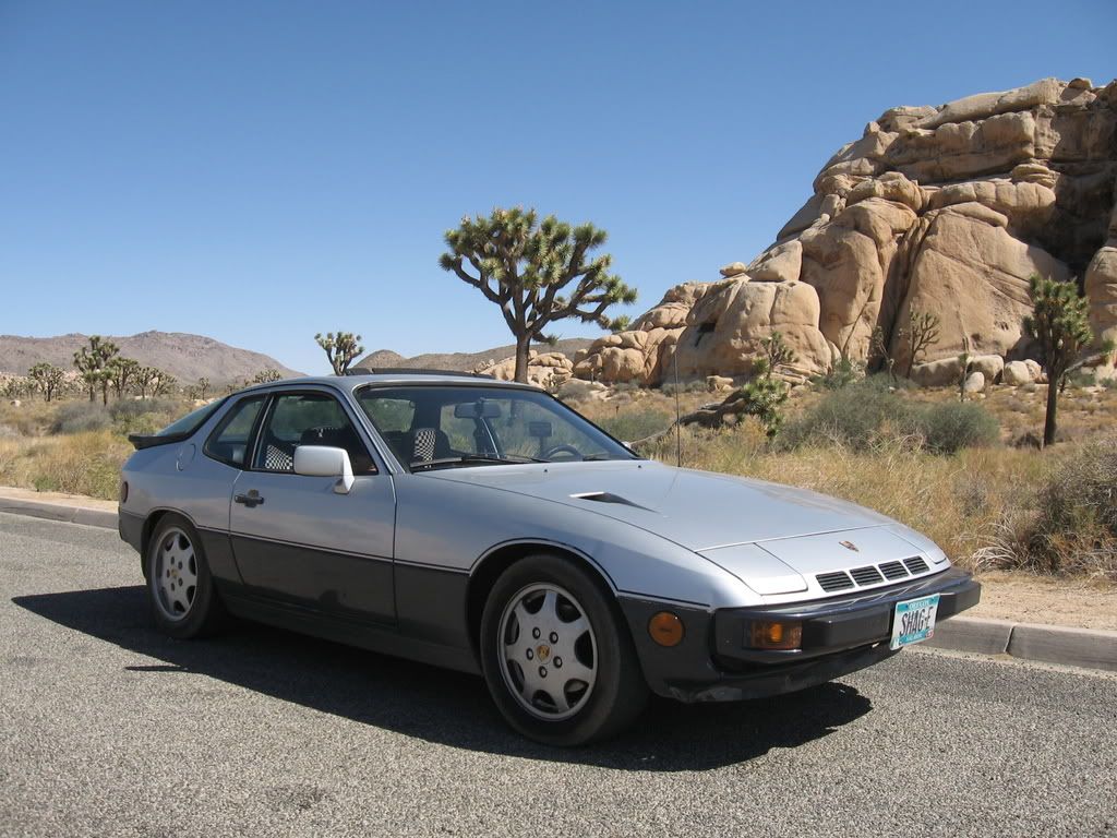

Those are 6 and 8, from a 911. I believe 944s were sold with 7s up front, 8s in the rear. I LOVE D90s!
Pictures, you say?? A bit dirty from the long drive from Oregon, but. . .
Nice pic of the car, James!
