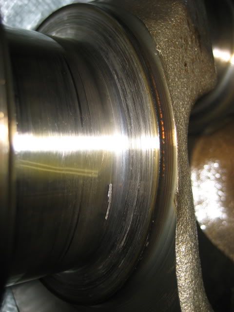

I'm in the process of disassembling the engine in my s2 and I'm having difficulty removing the girdle from the bottom of the engine. All the underside bolts have been removed and the girdle lifts at the front fine but will not release at the flywheel. Does the rear main seal have to be pulled in order for the girdle to come off? Is there another bolt or lock that I'm not seeing?

Managed to break it loose with a bit of leverage under a couple of tabs on each side of the girdle. Looks like years of hardened oil had stuck the two pieces together

More like, got a worn thrust bearing?

Only theory I've heard is that a previous owner could have sat at lights all the time with the clutch pedal in, and that pull on the crankshaft slowly wore the bearing out.

I've got an 87S with the same issue. Originally the clutch started to stick near the floor so I thought it was one of the hydraulic cylinders going bad. Turns out it was the thrust bearing. You doing a full rebuild or just the lower end?

the thrust bearing surface on the crank looks alright, but the side were it was spinning against the worn bearing did take some abuse. It should be fixable for a lot less then the $1000 it would cost to find a replacement

Oh... that might need some help. The thing is, I don't believe there are any measurements for thrust bearing sizes in the shop manual other than endplay clearance with the crank and bearings installed. It will probably polish out as long as it's not too worn. The thrust clearance range is fairly wide (.11-.312mm, max .4mm).
