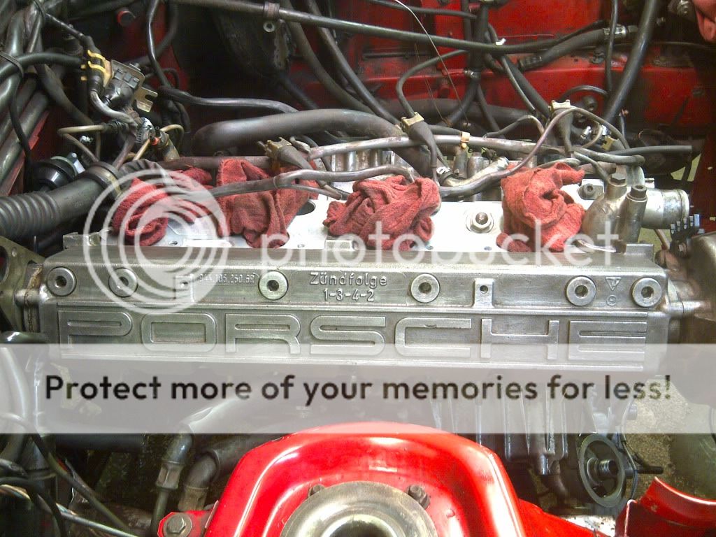

I'm sure most of you thought this thread was dead and I completely gave up in this project... well that's not too far from the truth. I did give up on the spare motor I bought but, I still had the problem of my engine burning oil and running quite rough.
So about a month and a half ago I decided to go through with my second plan that I came up with last October and rebuild the top end of the engine that's in the car. I figured I wouldn't have to spend much money on this since I had a Lindsey Racing engine rebuild kit just collecting dust in my basement.
I decided that the best time to start this project would be on my spring break from school since I would have a lot of free time when I wasn't at work. Once I was on spring break from school I started tearing into the engine. That was on March 19th. I kept saying that the whole thing would only take a couple weeks. But then a couple weeks turned into a couple more weeks and that turn into a couple more weeks and well here I am on May 3rd and my car is still sitting in the garage. :rolleyes:
I am getting very close though and hopefully it will be done soon. I'm sorry for not updating this thread sooner but I decided last minute that this was a good opportunity to bring some closer to this project thread and give some more info to anyone who was considering doing something like this themselves.
I'll post pictures and explain what I've been doing over the past month or so throughout the next few days. But to give you an idea of where I am right now I'm reassembling everything and I am finishing replacing the front seals. The cylinder head and cam housing are on and I'm waiting for my most recent order from Pelican Parts to come in so I can bring this project to an end.

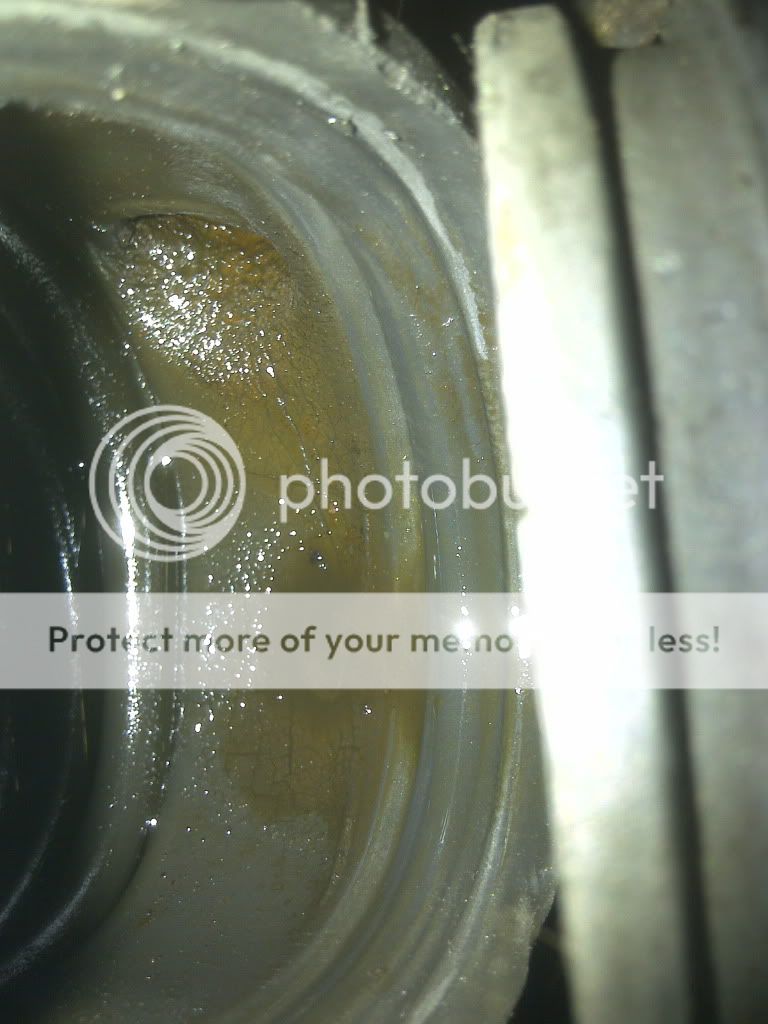

I'll start at the beginning in March... Here's what I found upon first inspection on my engine
Oil in the intake
http://i698.photobucket.com/albums/v...0314-00331.jpg
And oil on the spark plugs
http://i698.photobucket.com/albums/v...0320-00341.jpg
This was only the beginning of what I found wrong with the engine...

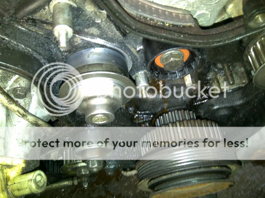

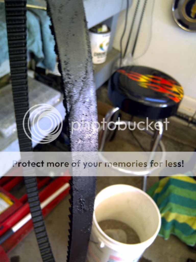

Once I had the intake and fuel rail off I moved into some other familiar territory, removing the timing belt and water pump. I decided to remove the radiator too for a few reasons; 1) Since this was a semi long term project I decided the extra room would be worth it 2)My rad was really wobbly which I quickly realized was due to the fact that it was only held on by one of the four rubber mounts :eek: And 3) I may have accidentally lost part of the drain plug in the rad and I wanted to try and shake it out. oops
Anyways once I got the rad out and all the belts off I realized just how much a favor I was doing my engine by rebuilding it. Look what I found:
http://i698.photobucket.com/albums/v...0326-00342.jpg
http://i698.photobucket.com/albums/v...0326-00343.jpg
http://i698.photobucket.com/albums/v...0326-00348.jpg
http://i698.photobucket.com/albums/v...0326-00350.jpg
There was oil leaking everywhere. Even on the timing belt! Needless to say that was scary to see.

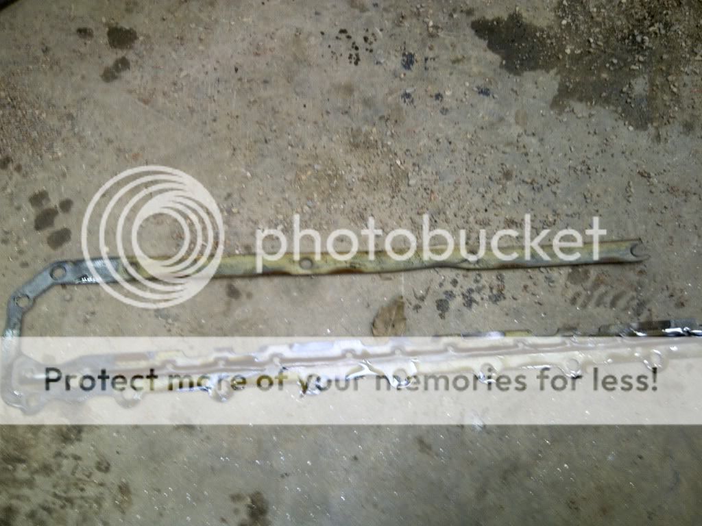

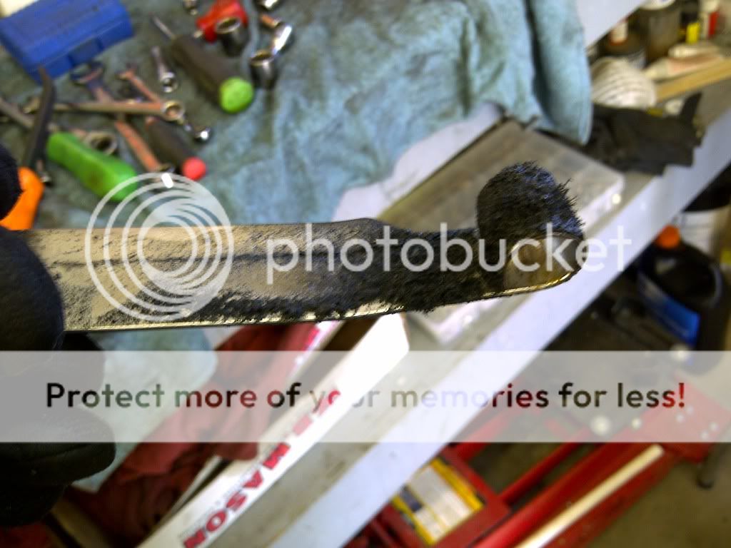

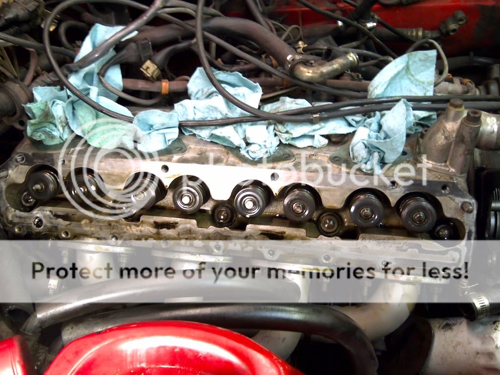

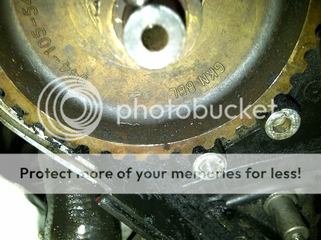

So where was I with my story time? Oh yeah, so after I realized how bad the oil leaks actually were I moved on to the cam housing and cylinder head.
I was as careful as I could be when I took the cam housing bolts out but I still managed to strip two of them. One of those I didn't realize until after I tried taking the housing off and wondered why it wouldn't come loose...oops. It turned out to be in the worst spot too right by the strut tower so it was nearly impossible to get the drill in there to drill it out. My advise to anyone taking any allen headed bolts off is to a) follow the "waking up" Procedure on clark's (It works wonders most of the time) and b) have a good drill and drill bit ready just in case.
Once I got the cam housing off I once again realized why I was doing this. The gasket was destroyed. It was very hard and brittle and came off in two pieces.
Here's what it looked like when I was done.
http://i698.photobucket.com/albums/v...0327-00355.jpg
And here's the gasket
http://i698.photobucket.com/albums/v...0327-00359.jpg
Taking the cam housing off isn't very hard to do by yourself even if it's your first time. Just go slow and tilt it towards you so you don't loose any lifters. When I did it none of them fell out.
