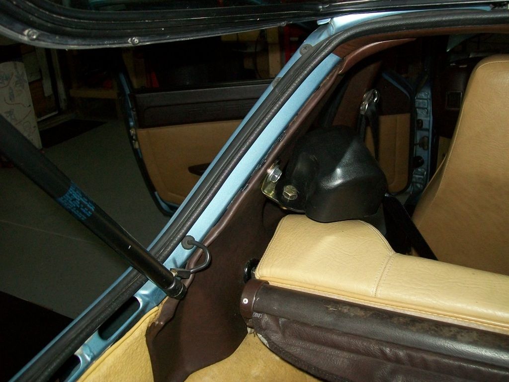

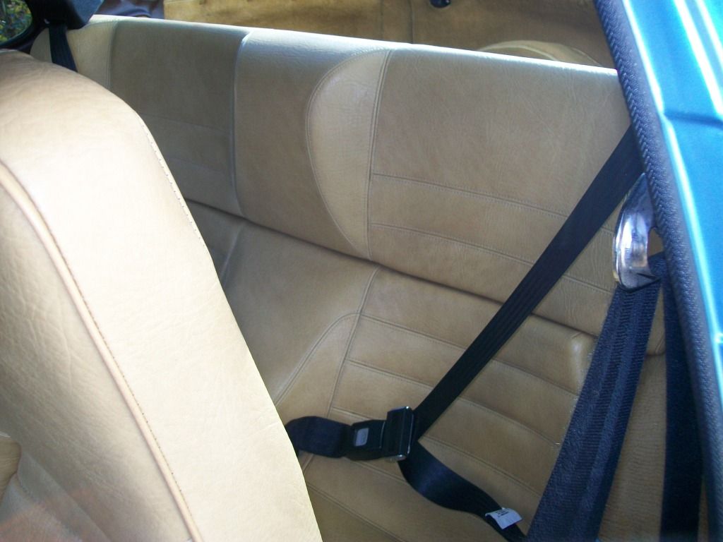

yup, got it done. Used this seatbelt.
Roadster 3 Point Retractable Seat Belt Bucket Seat
Pretty expensive in my book but the non- retractables are more reasonable. I used the upper mounting hole behind the plug for the reel, and the factory locations for the other 2 bolts. I also ordered a 90 degree bend from westco to orient the reel properly. I also had to hog out one of the holes in the 90 degree bend for one of the bolts. Can't remember which one. See pics below.
