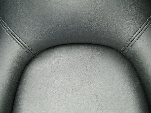

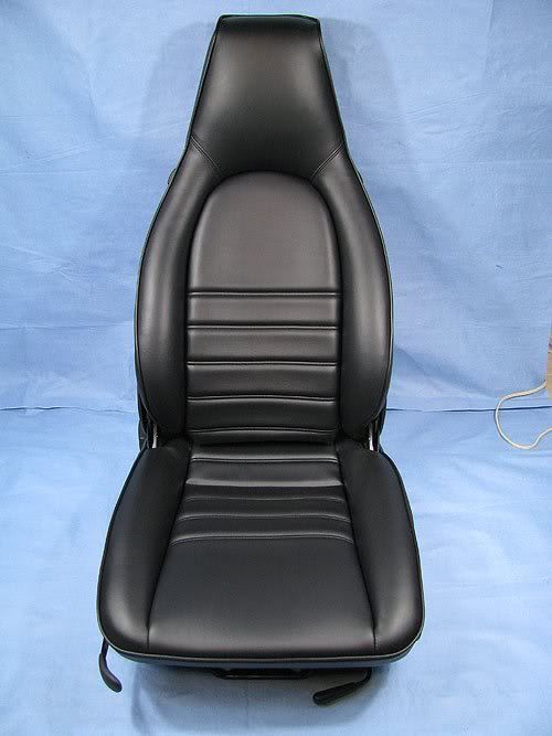

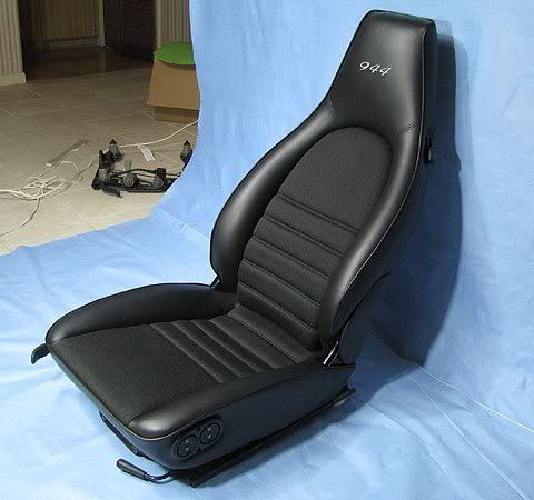

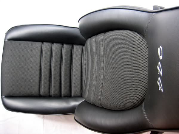

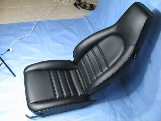

I bought a seat cover bottom on ebay a while back, it was loose and looked like crap so I learned how to sew and made my own. There was a lot more to it than I expected.
I started out with a old Kenmore Ultra stitch home machine (great machine) and now I have a Singer walking foot. You can certainly make a set of covers with a home machine and make them look ok, but it's a lot of time and effort to make them fit right and look really good.
The tech article above is pretty good, but one thing I'd like to add is instead of using rubber cement or tape to hold the pieces together, use a hand held stapler (not a desk top stapler) and staple the pieces together. I found that to be a revelation when I started out. Also, buy new pre made piping (or welt cord), it's pretty cheap and get a welt foot for your machine.
Here's a couple that I've made from german vinyl, porsche vinyl and Pontiac G6 cloth.
G6 cloth
German vinyl
Porsche vinyl
