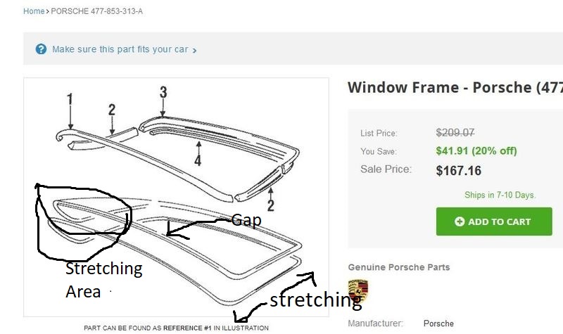

You guys are the experts, not me - I've only had this car for a couple of weeks. However, it really does seem that the thin metal on the front end of the glass is a moulding/trim piece that sits above the glass and isn't part of the frame itself. The part # is 477853313A. On the diagrams I've seen it is not part of the frame but sits above the glass.
The piece would need to be removed by anyone who has removed the glass and reglued it to the frame. So, I'm wondering how it comes off and what keeps it in place.
TheSecondChris 12-18-2019 10:27 AM
Does anyone know what holds this piece in place? Is it secured by glue or is it fastened to the frame or trim somehow. I'm referring to #1 in this diagram?
http://forums.pelicanparts.com/uploa...1576693512.JPG
djnolan 12-20-2019 03:56 PM
If there is a gap between the trim frame and glass on top there probably is also a gap between the frame and the glass underneath. This is most likely because the hatch frame has stretched at the frame side angle because of continuous pressure from the shocks and gravity.http://forums.pelicanparts.com/uploa...1576886427.JPG

Possibly welding a gusset plate at the side angle (stretching area) could prevent the hatch frame from stretching.
Just an idea, I have never heard of anyone doing this and I don't have the skills to try anything like this myself.
http://forums.pelicanparts.com/uploa...1577371362.JPG
