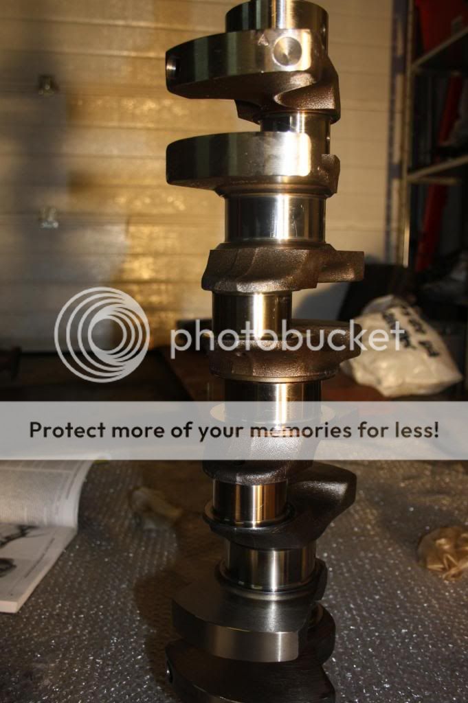

Yesterday I was tearing apart the shortblock of my 951 as I am rebuilding it. Everything inside looked very good. I cleand the block, checked all bearings (All was fine), and cleaned the crankshaft.
Then I thought I'd check the main journal and rod journal diameter with a micrometer to verify they were within the tolerance limits. The crankshaft looked flawless before I started.
Well, it all went wrong from there. I haven't used my micrometer for many years (And I have only ever used them once before), so I had forgotten how to use them. Probably used 15 minutes just to figure out how to read the measurements from it.
I found it hard to find the center of the journals, so I made the mic gradually smaller and smaller in 0.0010" steps and tried sliding it across the journal, to see what was the smallest opening that would pass. I know, stupid stupid stupid. It was late at night, I was tired, was working on the garage floor under the car that was raised all the way up on the lift, and had bad lighting. I actually tried wiggling the mic across in the narrowest.. I know, flame away..

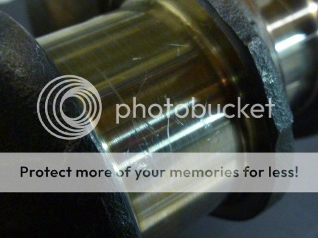

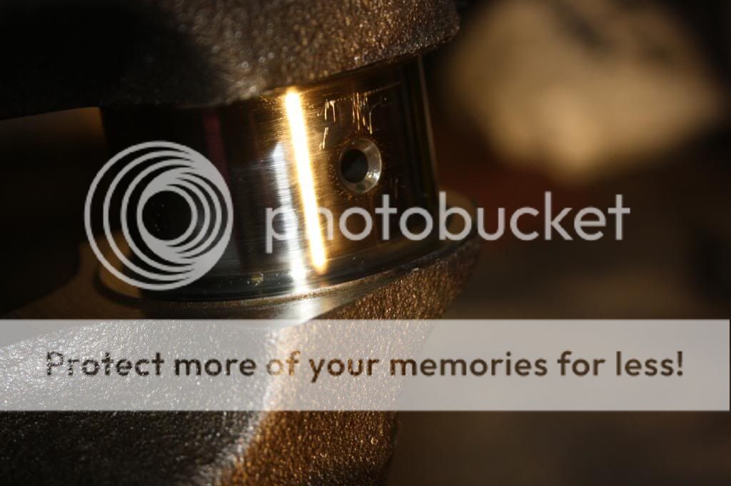

Well, when I put the flashlight to the crankshaft once more in the end for one last close inspection after measuring, I found all the scrathces my dumbass procedure had produced..
I stayed up till 3 AM that night, searching the web and trying to find out how to mend this. I then checked how I should have used the mic, and also found I should have used a ballpoint mic to get proper readings and avoid scratching, and that I of course should not have dragged it across like I did.
Anyhow, here are some pictures of the mess I made:
I can not feel the scratches with my fingertips, but I can feel them with my nail. There was one nick that was raised and caught my finger. After reading a bit about how people polish crankshafts themselves and different online recommendations, I used a 1200 grit wet paper and WD40 as lubrication, and carefulle removed the nick. You can't tell that the surface has been touched as the surface doesn't look changed. But the small raised edge is gone.
What do you think, can this crankshaft still be used? As far as I could tell from what I read online, as long as any raised microareas around the scratches are removed with polishing it doesn't matter that the scratches are there. They will simply hold a bit extra lubrication. But any material sticking out/raised area will destroy the bearings.

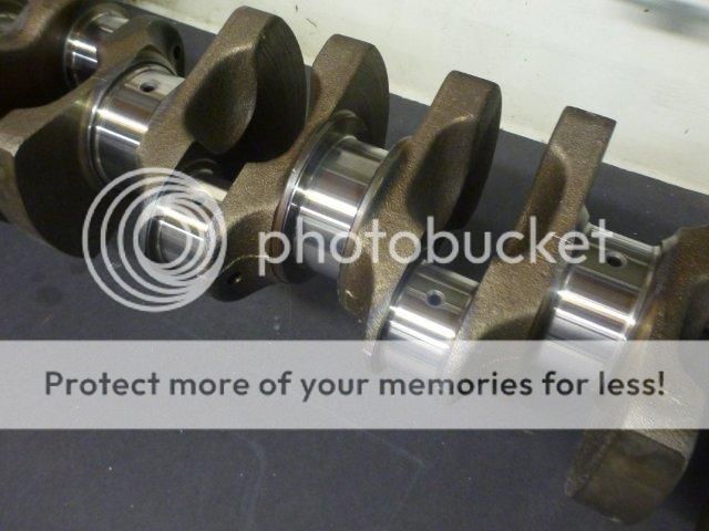

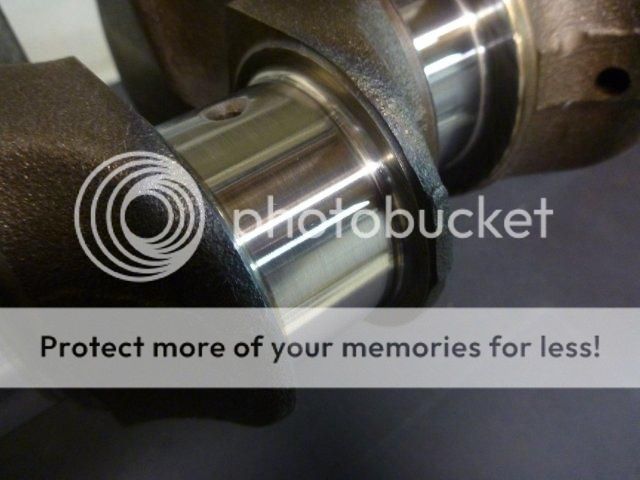

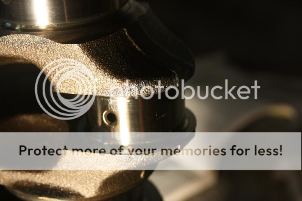

Update:
Well, they managed to polish away all the scratches and still keep it within spec.
Next up is balancing the whole rotating assembly.
Before shots:
After:
So this just shows that quite pronounced scratches can be polished away without removing noticeable amounts of metal.
