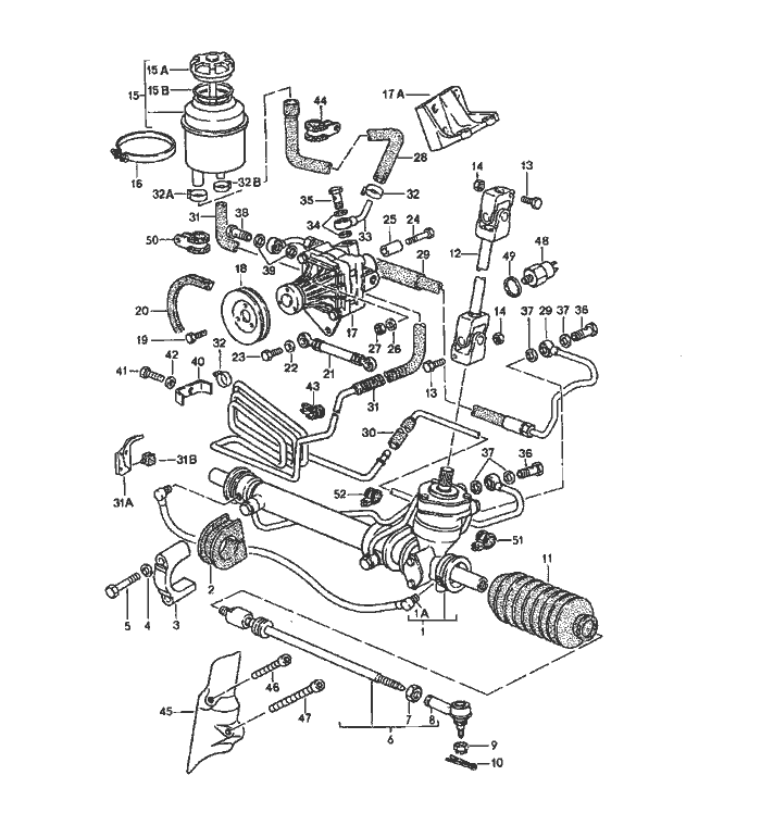

Ok, can not figure out the mounting of the Power Steering Pump.
Rear seems to have a large spacer and M8 bolt.
What goes in the front slotted mount? The pump has a threaded stud coming out, but it's way bigger than the mount slot so there must be some other pieces involved.
Thanks!

Nobody.
Looks like the rear use a spacer and M8 bolt.
Just can't figure out what to use for a spacer/washer and nut for the stud on the front of the pump.

There is a bushing that fits into the front of the mount. You can see it in the photo above inside the slot on the front mount. You place the pump by rotating it in with the front stud through the slot and start the rear bolt. Then slide the bushing onto the stud and into the mount. Add a washer and nut (M8?) and tighten everything up.

I think that front 13mm spacer is what I'm missing.
