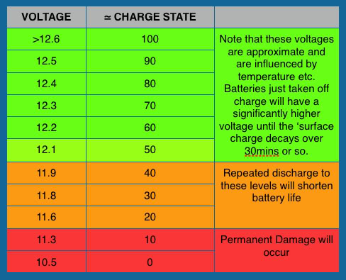

13.9 is about normal when the car is running and it should hold steady when the accessories such as the lights and A/C are turned on.
What is your battery voltage when the car is off and having set for a few hours? If low have it charged and tested.
http://www.audiocircle.com/image.php?id=128272
