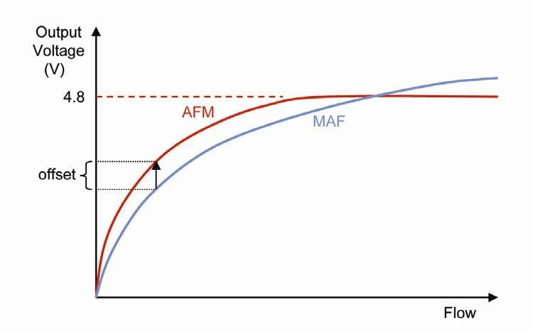

Has anybody tryed a DIY MAF maybe by identifing the Bosch sensor used in the kits? Presuming probably wrongly that the sensor just sends out a voltage reading in the same way as the AFM could this be a simpler process than we are led to believe..

It's been tried. You are trying to emulate the barn door's behavior and resulting voltage by inferring what the barn door would be doing by reading various signals from the MAF sensor. This is not so hard if every day was 70 degrees and the same humidity all day.
What you really need is a 3D map of the MAF reading at all expected conditions and a link from each of those points to a derived AFM voltage. You could do this with an Arduino but if you could do that you could probably afford a 968 or a Cayman S, which have a MAF already. Or will be able to when you graduate.

it is not just a case of "voltage conditioning"...everything about how a MAF works is different than the AFM.

To answer your original question though...yes, several people have tried to do this over the years, myself included, and it doesn't really work without getting into the hardware/software of the ECU.
Way easier and better to just buy the kit.

I've tested about 20 of them over the years and there and there's exactly zero that matches the factory AFM. That's why there's no MAF upgrades without a matching chip. The MAF+chip combination is a matched set. That's how there can be about 10 different MAF kits on market with flow-ratings from 200 all the way to 600 hp. Not a single one of them work with the stock chip because that is calibrated and programmed for output of stock AFM only..
What is your goal? I did this about 20-years ago, I'll give a summary to save you trial & error frustration. If you want more power without destroying your engine, you must do the following without skipping any steps.
1. Get chip-burner, a handful of blank 2732 or 2764 EPROM chips and a chip eraser. Or get a flashable emulator such as Ostrich.
2. Find suitable air-temp sensor. Easiest to extract factory sensor from AFM and measure its output response curve. About 10 datapoints between -10 to 110-C should be sufficient. Look up datasheets on Mouser until you find a thermistor with similar response curve to the stock unit. Buy a handful of these thermistors for $0.13/ea.
3. Figure out mounting method for thermistor ahead of MAF in intake. The mount should hold sensor firmly without allowing outside air to sneak in. Should also have connector to send air-temp signal to DME.
4. Select MAF of appropriate max flow-rate for your application. Don't pick a 600hp MAF for a 944na for example.
5. "Map" the MAF relative to the stock AFM; you can use a flowbench. This can be done by mounting the MAF inline with the AFM and logging both their voltage outputs simultanously as you flow more and more air through:
AFM MAF
1.0v = 0.8v
1.1v = 0.87v
1.2v = 0.93v
1.3v = 0.99v
etc.
6. Download chip-programming software. Rogue's site had some listed with pre-made chip-image definition files for 944/951 along with some transfer-functions of common MAFs on market. Pick one closest match to curve you tested in #5.
7. Dyno-tune your new chip at each flow X rpm datacell. There's about 160 data-cells on chip for fuel and 160 for ignition. Use a Mustang dyno so you can hold engine precisely inside each flow X rpm datacell as you adjust for optimum AFR and ignition in each cell. Repeat for each data cell.
8. When done, dump image to chip.
9. Build appropriate intake plumbing to hold MAF. It should match factory config with getting cold air from the fender.
Plan on budgeting at least 200-300 hrs labour to do the above and about 10 hrs on dyno.
