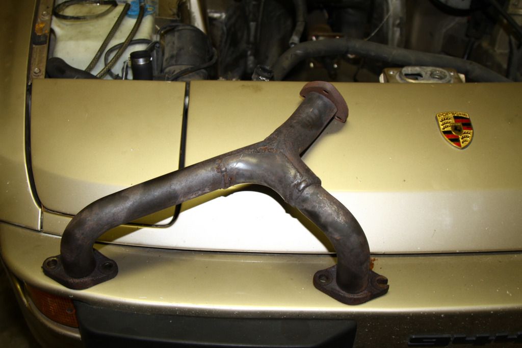

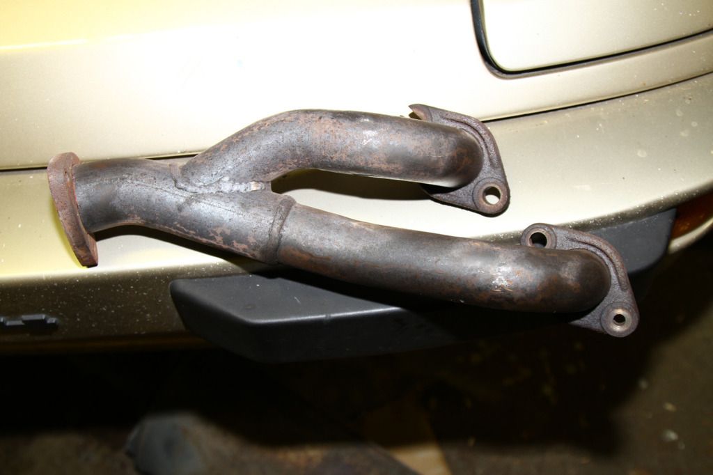

Sorry it took me a week but here is the set I have from a '88 2.5 motor I parted last year. There not cracked and this is the latest and best rendition with better welding and heat shielding to make them last aong time from factory. Yes these fit 1983-1989 8 valve 944 engines all the exact same

The tubular units are WAY lighter than the cast ones. There's a 13lb difference per set. Both generations of stainless manifolds weigh the same at 7bs/ set. The cast ones are a solid 20 lbs /set!
As a builder of the 944 Spec class race cars, it's important for me to know the weights of early vs late parts because we can legally update/backdate parts.

The 1-4 cylinder manifold pictured directly above is the 85.5-86 first gen stainless steel unit. The 2-3 cyl piece almost never cracks, but these 1-4 pipes are almost ALWAYS cracked under or around the gusset. You can weld them and they WILL crack again. Recycle them. Better to go with the older bullet proof "cast iron" ones, or the 88 double-jacketed ones.

Old 04-26-2016, 09:51 AM
Comeau Racing
Join Date: Dec 2004
Location: San Diego, CA
Posts: 1,519
Blow these pictures up and count the cracks!!
