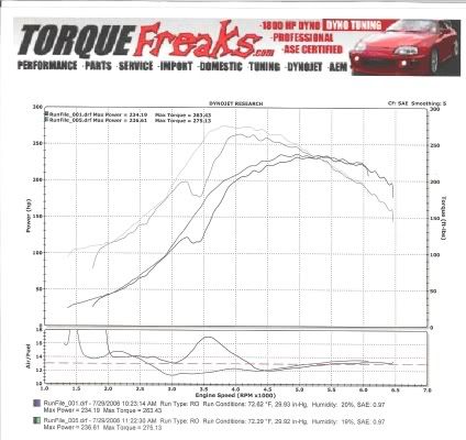

After reading the few threads I could find on fuel pressure, I came to the conclusion that with an aftermarket FPR the psi should be at 42.5 or 3 bar and should be adjusted at idle with the vacuum line removed. At idle, with the line connected, the gauge was bouncing around 45 or 47. When I removed the vacuum line the psi jumped to around 55psi. So I adjusted it down to 42.5 and reconnected the vacuum line and now it sits steadily at about 42.
I was wondering if there was any reason why the pressure was set so high and since it was, if there would be any effects? My car has the GURU MAP, 3" exhaust, and running about 16 psi of boost. I took it out afterwards and it seemed to be better, but I could be imagining things.

if it's set too high, it will just dump more fuel, and your performance and mpg will go down.
if it's set too low, it will lean out at high rpm's and you'll blow your motor.

55psi at idle is too high. it should be at around 36psi at idle on a stock car.
do you know if you have stock injectors? you should also ask guru racing what the fuel pressure/injector requirements are for the chip you have, i know they have more than one chip.
what other mods does your car have?

it's possible that the p.o. had it tuned for higher boost and more fuel to match the chips. what boost does the gauge show?
maybe it's time to dyno the car and see the actual a/f graph. if you turn this down too much without knowing the a/f, you could do serious damage.

The car is running at about 16psi of boost from what I can see out of the corner of my eye while I'm driving, maybe 16.5. The PO had it at 17.5 when we did the exchange, but I decided to turn it down a hair. The FQS switch was set at the 4th position option that gave it a 2 degree ignition retard. But I went in and changed it back to the "0" position which is GURU optimized 91-oct. (R+M/2) pump gas up to 18psi boost with stock injectors. Here's a link to what I'm talking about. FQS Adjust Not that I really know what the difference would be between an advance or retarding the timing, but I'm not doing above 18psi. I wish I knew how to use this GURU system; have tried reading through all the "steps", but still not understanding.

Have an appt. with TorqueFreaks this Sat. (7-29-06) at 10 to do a dyno with air/fuel to see where it's at and maybe some tuning. Will post results as soon as I have them.

Ok, so I have the results. Doesn't look too horrible from the start, but nothing too great either. The blue is before the adjustments, green afterwards. As you can see, there was a real nasty spike from 3k to 4k RPM which got leveled out. From what the tuner was telling me though, my fuel was maxing out at 5k RPM which seems kind of odd. He says I have the pressure adjusted correctly, but apparently I'm maxing the injectors out already. I don't know, the pump should be good up to 500hp from what I've read. No matter how much he tried to crank up the settings above 5k, nothing would change the line. So I might put a methanol/ water injection system in before I hit the tracks in a couple weeks. From what he was saying, it's in the danger zone above 5k running around 13.2-5 AFR. I wanted one anyway...
I just realized it's too small to see the numbers. Blue run was 234hp and 263tq, green run was 236hp and 275tq.

looks good after the tune. do you know if you have stock injectors?

They are indeed stock injectors, although from what I read I thought the stock fuel system was good up to 275'ish hp.
