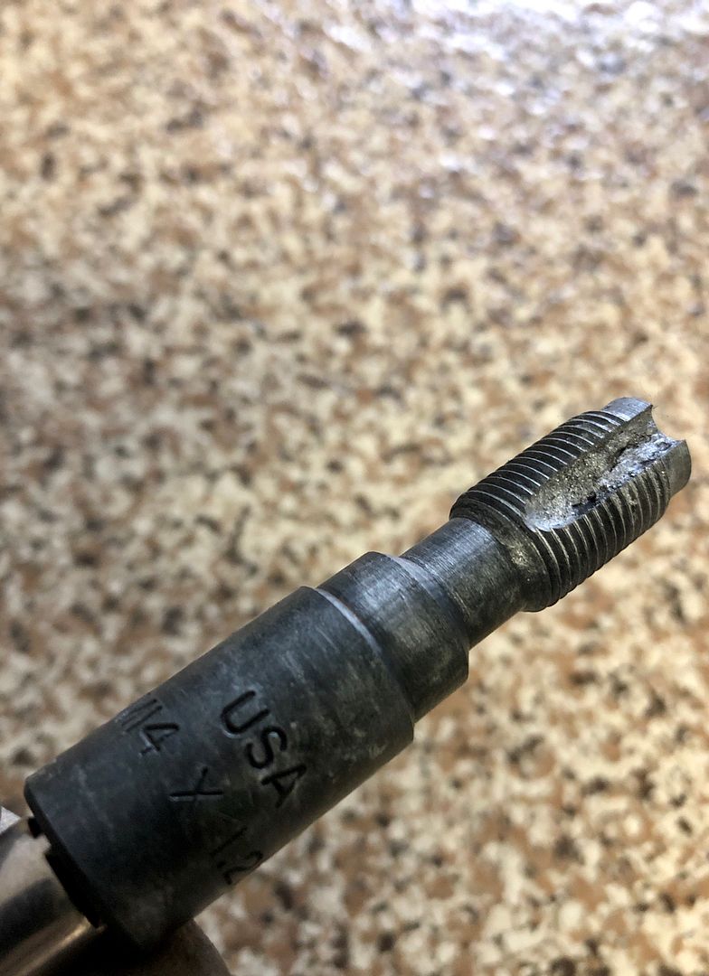

I had this happen during a recent plug change on a friend’s 993 (exhaust bank). Unthreading it was difficult enough that I purchased a proper M14x1.25 spark plug thread chaser to clean the threads. The new plug went in smoothly after that.
