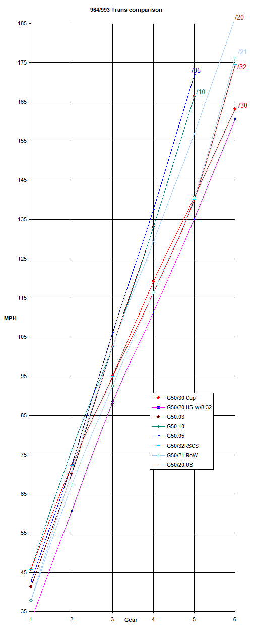

The problem w/ stock US 993 gearing is that 1st is too low and 6 is too high, you can livw w/ 1st but 6 is almost useless, a regeared trans is so much more useable and enjoyable.
just for example
here's a comparison of a couple of 964 5spds, /5 & /10, some 993 6 speeds /20./21, /30, /32 and some regears
notice that the 5 speeds are further left(bad for sporting purposes) the 993s are in the middle, /20 is stock US 993, /30 is 993Cup/RSR, /32 is 993RS/CS, any of the /3x are going to be great street/track transmissions, the /21 is a street trans geared pretty much like a 993RS /31 also good, the regears are liveable on the street
another comparison of stock US 993 /20 w/ a RSR/Cup race trans /30, here higher is more thrust

Great info bill. I wondered why my 95 felt like granny gear in 1st and only pulled 28k rpms at 80 mph ?

Well, this completely opens my eyes. Thank you for the information Bill.

Bill I am considering a similar project to the OP
I had a friend who had a nearly identical set up to my C2 except he had a 993 G50/20 in his vs my G50/05. We found I was a bit faster on most tracks due to less shifting I needed to do on some sections although neither was ideal.
I plan on building a new track car. Right now I have my eye on a gutted 993 with varioram engine or a 964 C4 requiring massive amounts of work. I plan on converting it to a 3.8 RS rwd clone if I go this direction. In either case I plan on using the 993 varioram engine and possibly a G50/20 tranny. Ideally I would like to gear the G50/20 to 30 cup setup. However we know the expense involved with gears and I was curious of your thoughts on using the 8:32 with the G50/20 instead of the extreme expense of doing the gears initially. I would rather put the money into other things right now or am I wasting my time.

I don't like cwp change, while it makes some things better it makes others much worse
Here's a healthy 3.6 w/ stock /20 and a cwp change to 4, at the top its sort of like a typiczl /20 regear where 5 is moved to 6, but look at 1, it was too low before now it's almost useless
compare that to this where 5 is moved to 6
compare to a /21 and a /32, the /21 was the Row trans for early 993 it still has the too low 1 but the rest of the gears are very similar to those used in the RS /31, the /32 was the RS/CS something like this is what I would look for
the /30 used in the 993Cup and 93RSR is nice but does't need the really short drop into 6
All the above are the same 993 3.6
this is mine, /30 w/ 993 RS engine compared to the original /20 w/ the same engine. the only thing i'd change is to make 6 a tad taller as the tail of 5 drops below the 6 curve. Of couse if the rev limit or torque curve is changed the gearing would need to be changed too.

A lot of food for thought. Many things to consider. This will come in handy in the upcoming months. Amazing how quickly it all adds up.
