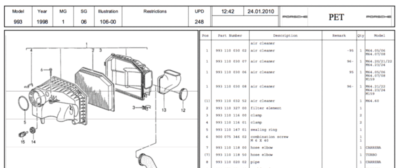

1995 993 Airbox
Is the airbox assembly and intake boot for the varioram and non-varioram engine the same? Are they interchangeable? If not, what are the differences? Thanks!

PET says difference from '95 to '96

The inner air box is different due to the different shape of the varioram intake in comparison to the 95 plastic intake.
