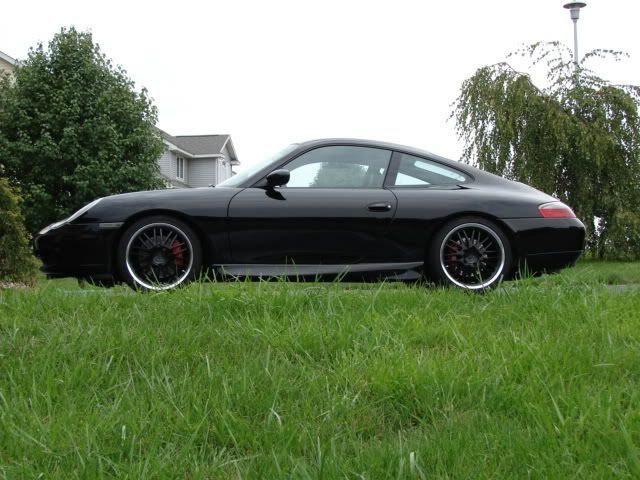

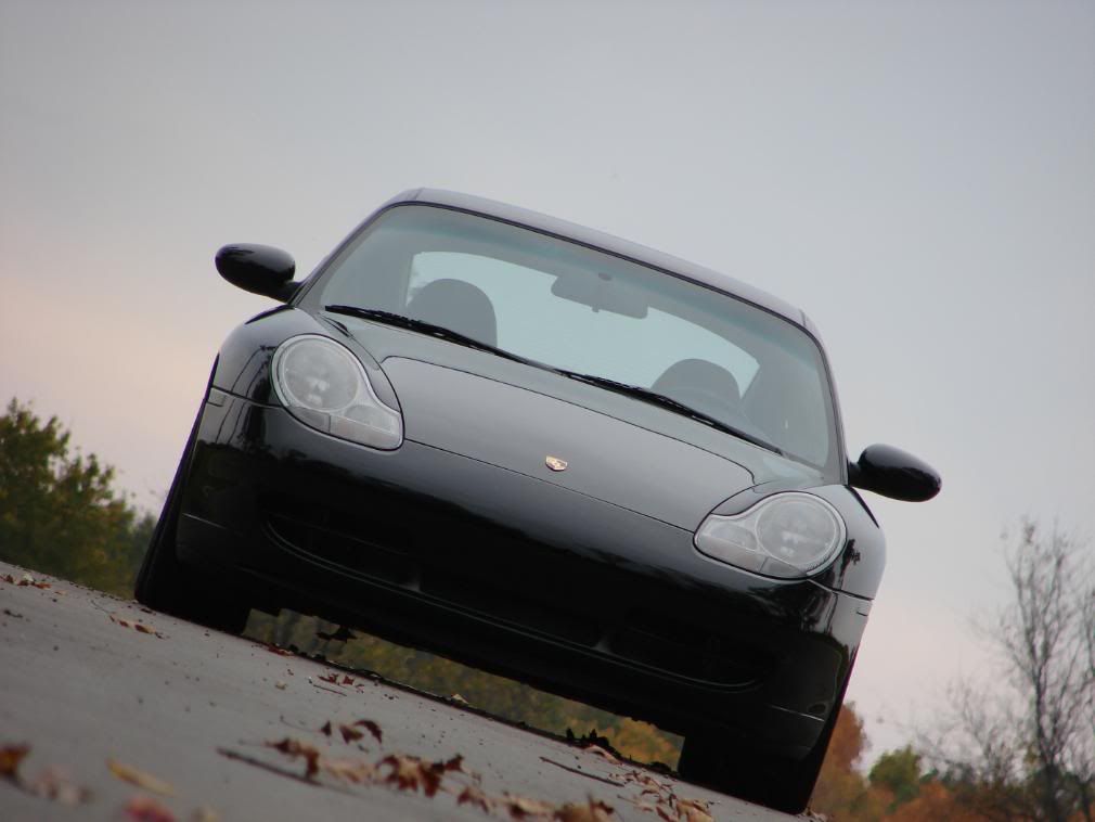

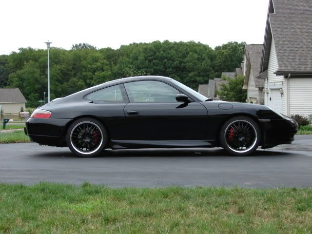

Here's the 996:
...and where it's normally driven:

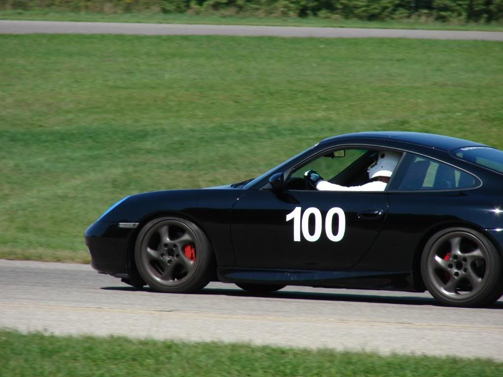

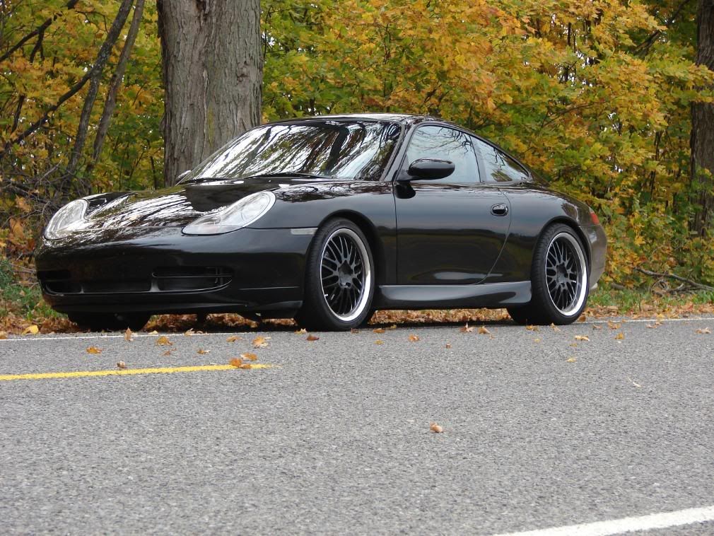

Originally Posted by glenndeweirdt View Post
Great photos in the woods! What camera lens and settings?
Thanks Glenn, believe it or not, these are taken with a Sony Steady Shot DSC-H2 on the automatic setting.
Here are a few more from that day:

Jerry, your car looks really nice. What side skirts do you have, GT3? How much is the car lowered?
Johan
Old 10-30-2007, 03:27 PM
jstgermaine's Avatar
Join Date: Feb 2002
Location: Battle Creek, MI
Posts: 1,222
Johan,
The side skirts are the OE GT3 Aero Sides. My car didn't originally come with the Aero Kit option, but I sourced the applicable parts. Over the winter I have to respray the hood and fenders from track abuse and at that time I'll install the OE GT3 front bumper, rear spats and a GT2 type rear spoiler.
As far as suspension, I am running H&R RSS Club Sport Coil Overs. They are set at right around 1.75in lower in the rear and almost 2in lower in the front.
Most people do Bilstein PSS9s as coil overs on the 996, but they were a bit too soft on the dampening for the track. The H&Rs are firmer than the firmest PSS9 setting but I don't find them uncomfortable on the street.
I have a set of GT3 adjustable sways that are going on it as well as some adjustable camber plates for the front and rear.
Good luck with your search.
