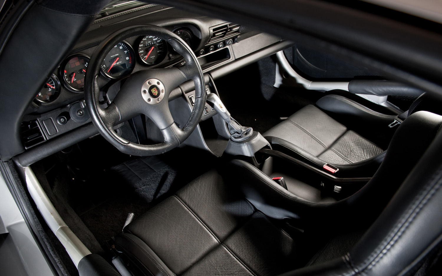

Porsche made a car with exposed shift linkages:
Good luck with the project!

Super cool I never paid any attention

I never knew that either and super clean rebuild man!
