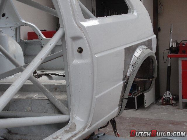

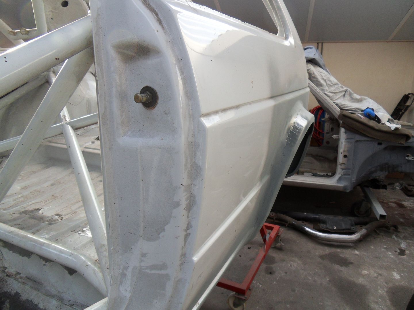

on the front and rear the arches are about an inch wider than the original ones

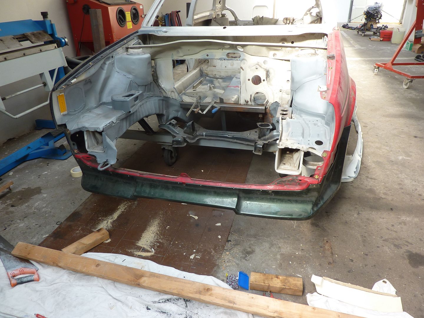

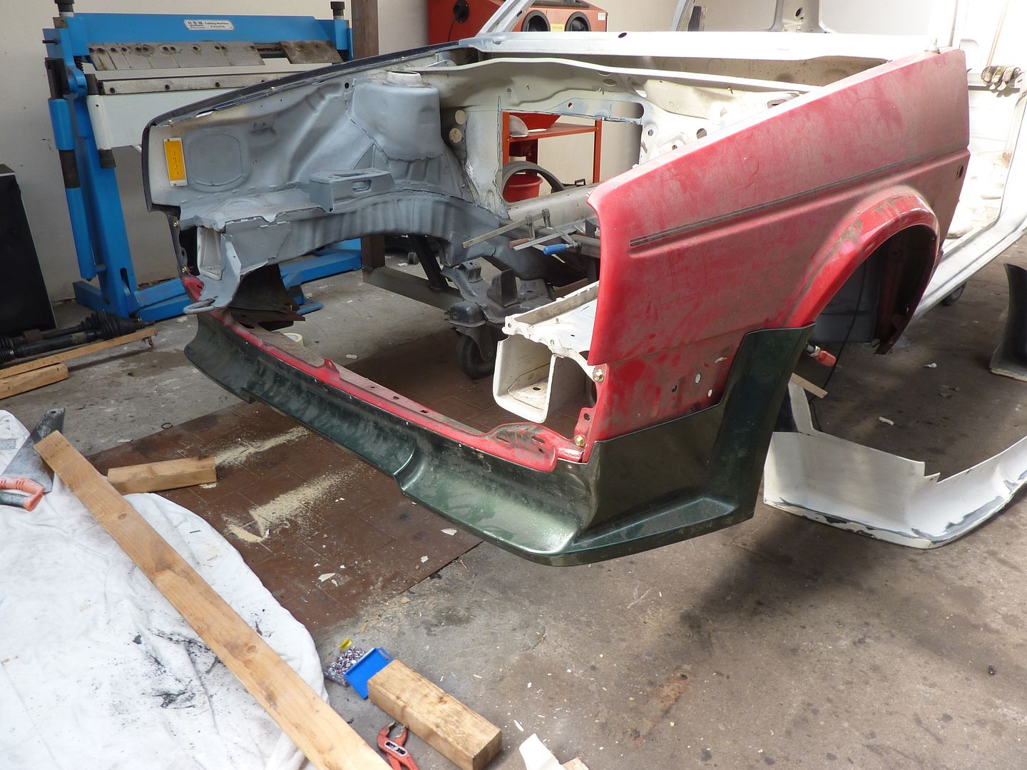

the front is completely welded through

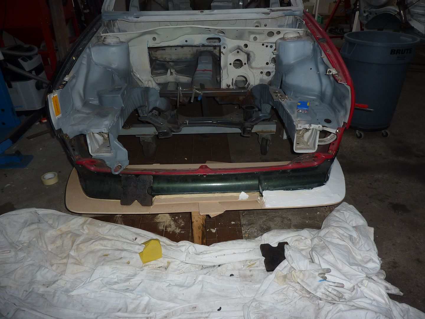

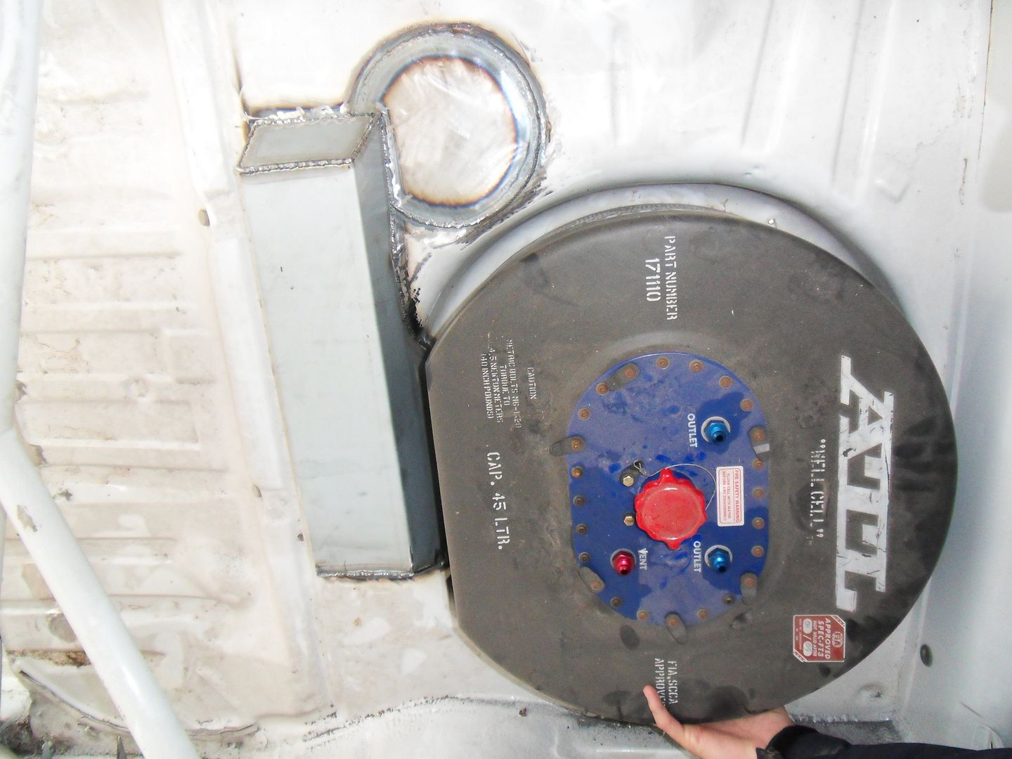

so the part for the spare wheel has been cut out and a flat piece of sheet metal in return

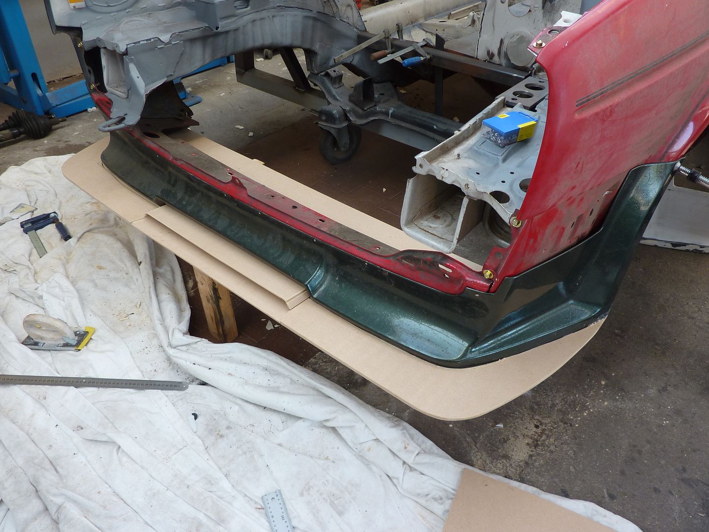

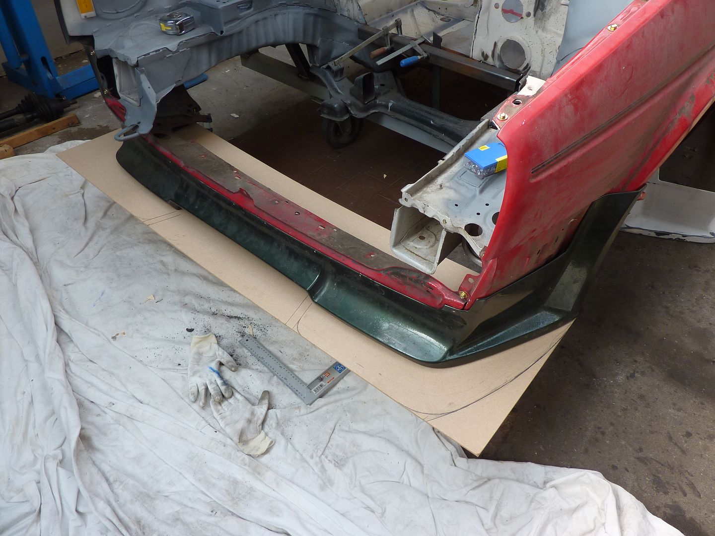

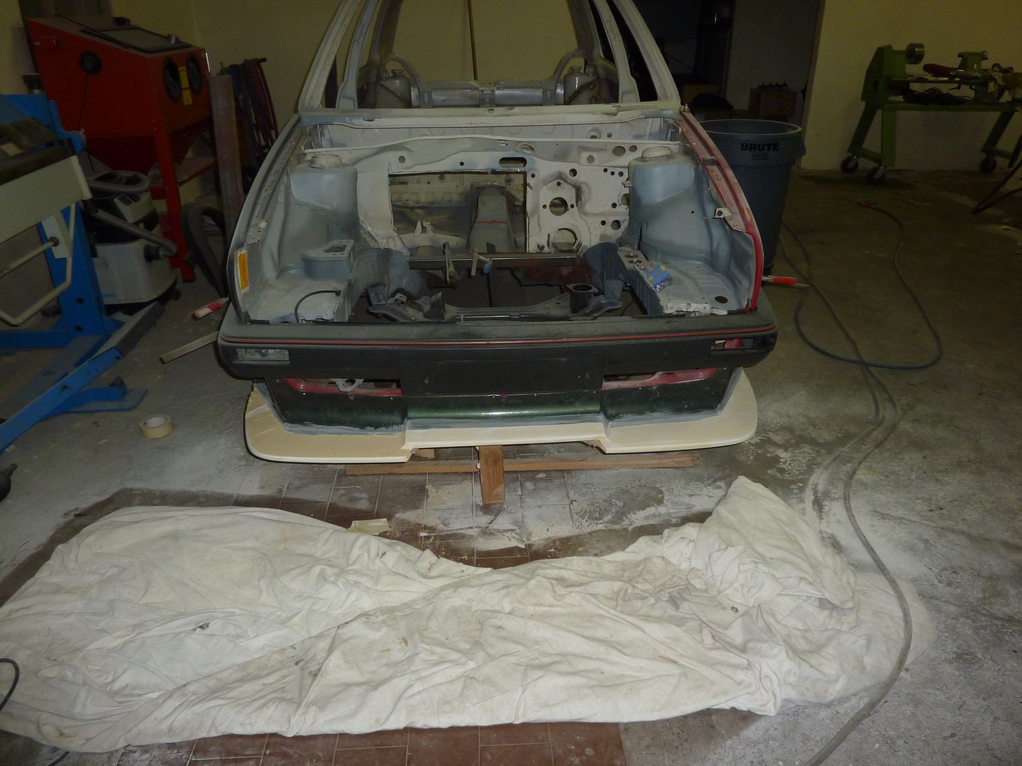

i was also busy creating a front spoiler for a bit of downforce,once finished i shall make a mould from it to let it manufacture in carbon fibre

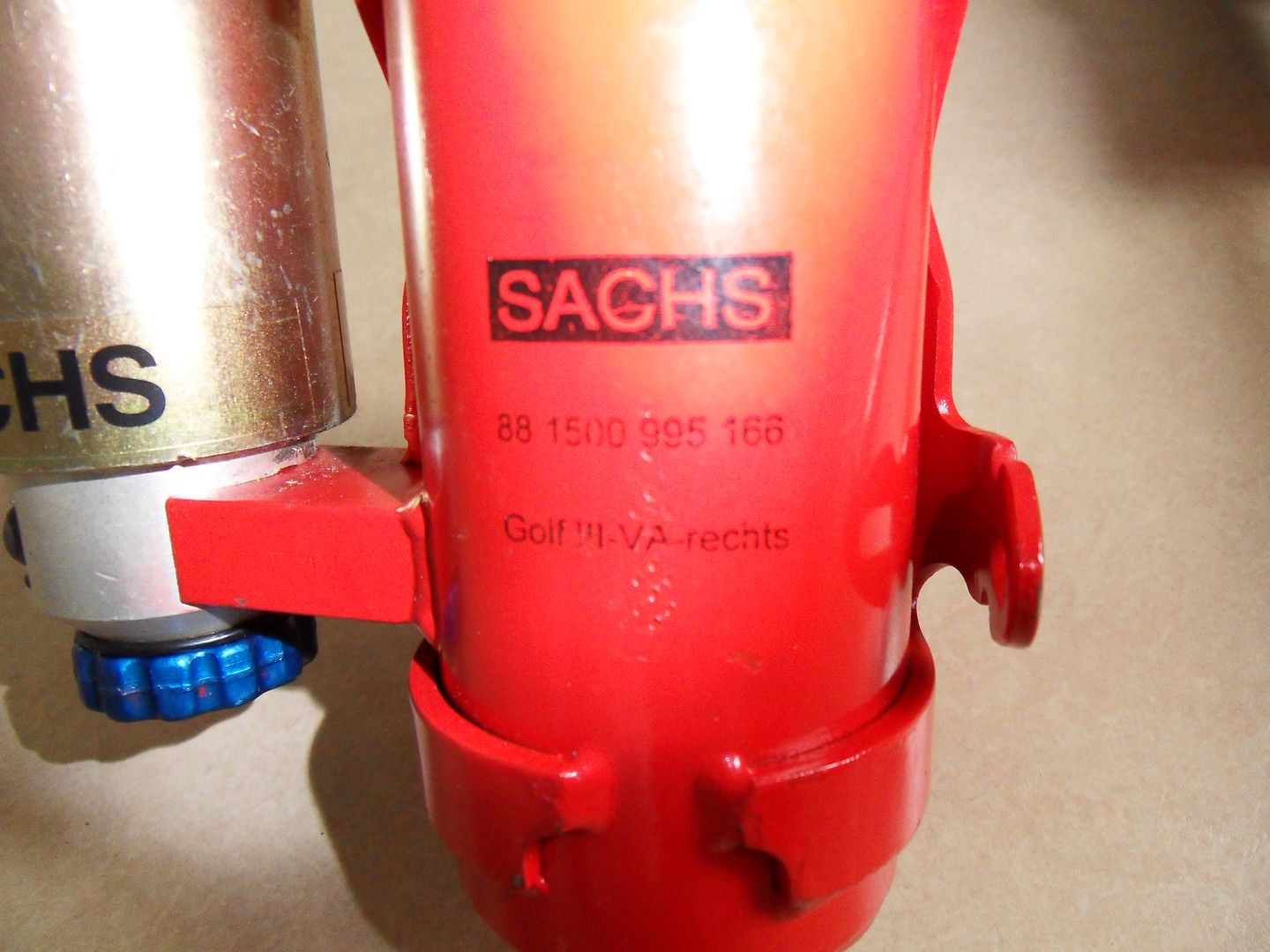

as for the wheels i use bbs centerlocks
dampers from sachs racing as used on a mk3 in the german touringcar series
