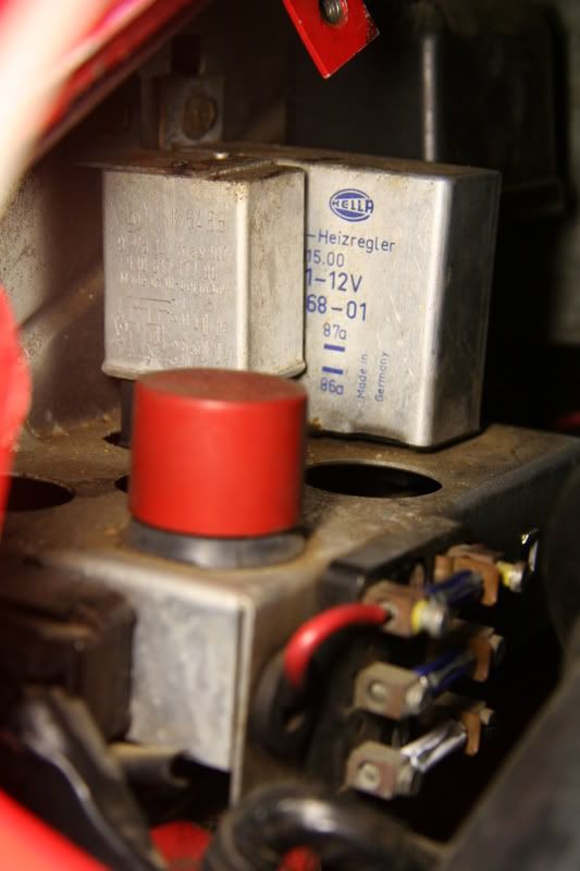

Thanks a great deals for the images! I think it may be either one of the relays or the overboost which I will ground today to check

OK ...I think I am wrong on the yellow as a turbo protection relay. Based on the shop write up it cuts the fuel pumps and then cuts the CDI box.... as it says for an orderly reduction in combustion... I guess this is part of a shut down procedure to clear the cylinders of gas due to the continuous fuel delivery process...The over boost relay is the round relay- red/blk and that cuts the power to the fuel pumps when the over-boost sensor causes the relay to trip....

thanks for the pics. But now I'm getting a little confused. Here's my board, looks like the 1977 diagram. Are one of my two silver rectangular modules supposed to be the yellow relay talked about in this thread? Or is my red round relay supposed to be yellow? Also, I did not see anything physically wrong with the red relay, no cracks of the prongs or the housing. Might it still be bad? (I'm not an electrical engineer, pardon the ignorance)
Am I remembering correctly that I used to hear the buzz of the fuel pump w/ the ignition in the on position? It also seems that there are two fuel pumps for the 930, I can't imagine that both have died on me at the same time. (I do hear the high pitched noise of the CDI still)

You will only hear the pumps pumping when the engine is turning. The flap meter in the cis has a sensor/switch. This sensor/switch can be overided (pumps on when ignition is on) simply by disconnecting it, no bridging of wires is needed.
Also, my 930's board looks like yours vmb.

Is track car and pumps come on when you turn on the key. Is 12 Plug system with dual Bosch boxes and duel coils. (all Porsche OEM - no aftermarket)
I swapped the red and black relays after which it would not even initiaize the starter. Even after I swapped back - nothing. I tapped on the relays with a screwdriver and then the starter would engage but she still will not crank. There is fuel and I pulled a couple of lower plugs (12 plug system) and while damp they do not seem to be soaked. There is a gray relay that seemd to be for the ignition. Anyone familiar with this relay? If I have fuel, fire and there appears to be no CIS air leakswhat could be preventing her from starting? Prior to the aforementioned eveny she would fire on the first turn of the key. Relay?
