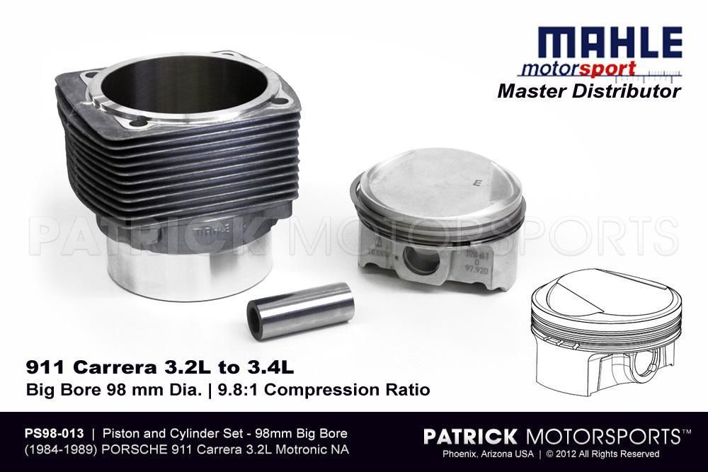

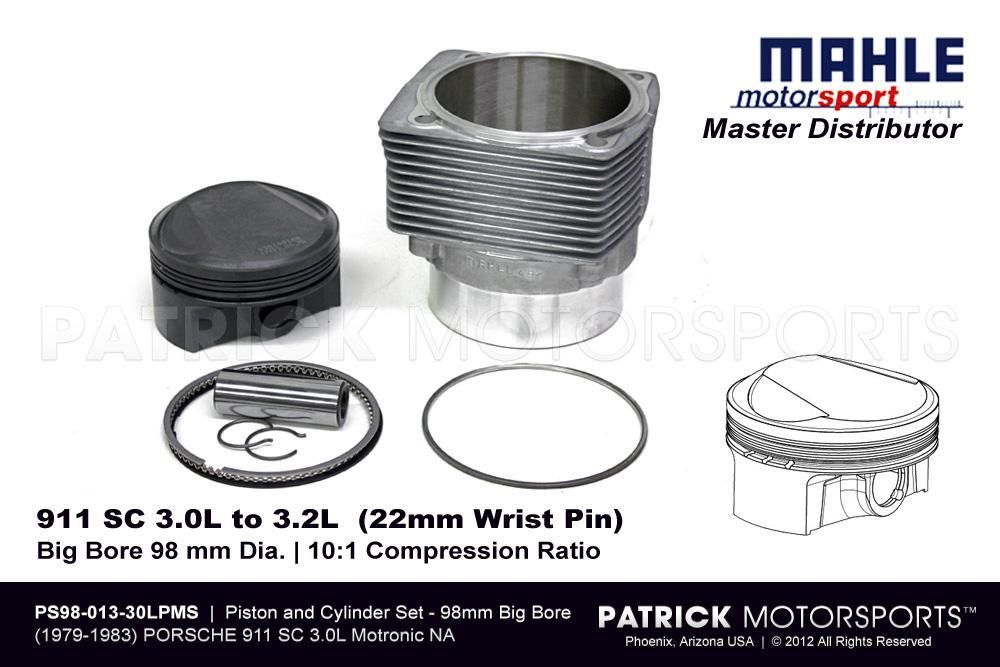

Patrick Motorsport still offers both the 3.2 and 3.4 Mahle wedge P&C. They list the 3.4 set, like you have, as 9.8:1 CR. They list the 3.2 set as 10:1 CR. That would require a dome volume of around 38.5cc, yet Mahle says, according to others research, there are only two dome volumes of 35.4cc and 28.3cc. So who knows?
I guess my assumption that the 3.2 Max moritz pistons are 28.3cc assumes that the data given to the other member from Mahle was correct. As you say, best to run the numbers by Mahle, or measure.
