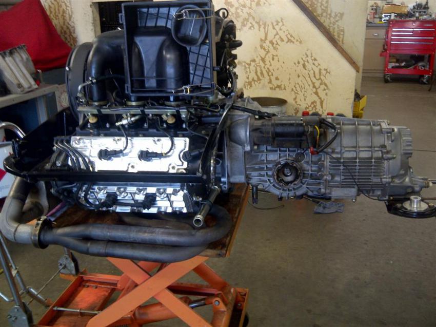

History 1978 SC with 964 3.8L - - Current - Built by Don Jackson Enterprise - Phoenix, AZ
1978 SC with 1984 3.2L built by Aase Motors Fullerton, CA - - Previous and as purchased March 2008 from Chris Wiles POC California
Exterior Fiberglass hood, 3.8 deck lid, front air dam and splitter, and read bumper cover.
Rear wing added
2016 Widebody 930 Front/rear fenders rear bumper cover paint changes to red front fenders and yellow stripes - copy of 996 Euro Cup UPS Series
UPS at CVR 2-14-2016
Interior Stripped - - roll cage welded -- Recaro race seat - - dash replaced
Performance Upgrades 2012 = 3.8L 964 rebuild from core - 12.5 CR - WebCams 20-21 cams - dyno tuned and chipped by Steve Wong
Engine / Under the Hood 2020 = 915 Rebuilt and replaced 4th gear by CMS - added spray bar and replaced trans fluid cooler pump
2020 = Engine out valve adjustment, spark plugs, fan belt, rear main seal, chain cover gaskets replaced, checked clutch ok
2017 = Refreshed 3.8 - rings, Clevite bearings, cams, lifters, heads machined for equal height, new Supertec head studs and ARP rod bolts, Clevite small end rod bushings, rods balanced
2012 = 1992 964 rebuilt 3.8 race quality engine Built by Don Jackson Enterprises - Phoenix, AZ
2012 = Steve Wong Dyno Tuned
2013 = CMS Rebuilt/Modified 915 Transmission
Suspension 2019 = Replaced rear stub axles and added 935 swing plates from Tarett
2017 = Replaced front struts parts from Rebel
2017 = ERP/Tarett 935 Front suspension
2015 = Elephant Racing Coilover Spring Conversion
Wheels and Tires 10.5 inch rear with 315-35-17 Hoosier R7
9 inch front with 245-40-17 Hoosier R7
