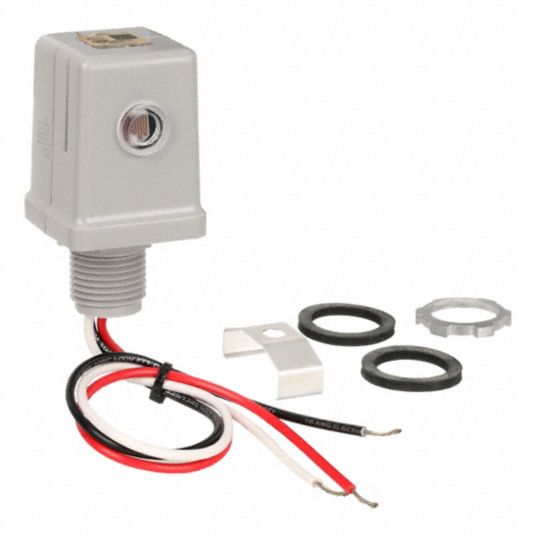

techman1 12-07-2024 01:56 PM
Electrical Help!!
While in the garage, heard a loud pop.
Exterior breaker box soot around it.
No breakers thrown anywhere.
All gfci functional.
What is this attached to the bottom of the exterior service box, as the soot and pop appears to have come from it.http://forums.pelicanparts.com/uploa...1733612520.jpg

carambola 12-07-2024 04:15 PM
that appears to be a photocell
techman1 12-07-2024 04:28 PM
Not photocell. Spoke to neighbor. Also has one, don’t know what it is.

dad911 12-07-2024 04:56 PM
To me also, eye turned towards the wall to reduce sensitivity. Pretty common back in the day.
https://static.grainger.com/rp/s/is/...ei=536&wid=536

dad911 12-07-2024 09:47 PM
Originally Posted by flatbutt (Post 12370592)
What is it's purpose?
Basically it is wired like a switch. On at dusk off at dawn.

Appears to be connected to supply, and nothing else. Still a mystery why it is there. http://forums.pelicanparts.com/uploa...1733671543.jpg
billybek 12-08-2024 07:37 AM
Whole home surge arrestor?
If that is what it was, they are supposed to be wired through a breaker, not unfused and unprotected!
stevej37 12-08-2024 07:49 AM
You'd think it would have gone 'POP' a long time earlier if it was a photo cell wired that way!
billybek 12-08-2024 07:58 AM
I don't think it is a photo cell as there are no switched legs coming off of the the device only line voltage (unfused) leads going in.
That is why I thought that it could be a misapplied whole home surge arrestor or protector.

dad911 12-08-2024 11:07 AM
That is a sub-panel?
I've never seen, nor do I see how it is legal, to have something connected like that unprotected by a breaker.
3rd_gear_Ted 12-08-2024 11:17 AM
Originally Posted by dad911 (Post 12370865)
that is a sub-panel?
I've never seen, nor do i see how it is legal, to have something connected like that unprotected by a breaker.
+ 1000
techman1 12-08-2024 12:11 PM
Main panel.
As for legal, a walk thru my central Florida neighborhood most of the houses have it !
I also question the safety of that was broken off, and shorted or touched!!!
