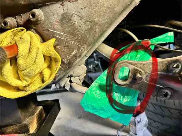

Hi my fellow pelicans,
I was hoping that you would advise me in this please. I am doing this for the first time, hence I am not so confident but I think I can do it.
The DIY article said this “ The way I do it (and I do it often), is to remove the lower-rearward bolt on the torsion bar cover and the lower shock bolt.” Did he refer to the bolt I circled in red?
Once I remove the lower shock bolt and this rearward bolt, is there any order of other bolt removal in order to readjust the spline?
Any advice you could help, I truly appreciate it.
Cheers.
Tom

75 911s 02-02-2025 02:22 PM
Short answer is yes. When the tension is off the spring plate, it's resting position is below that bolt, so instead of it being under tension against that bolt, the idea is that you move it out of the way for reindexing the rear torsion bars.
Now, is your real question is how do I lower the rear of the car?
There are two ways:
Minor adjustment (with the two bolts close to the torsion bar on the spring plate.
Re-indexing the spring plate to the torsion bar for a major adjustment.
If you can't get it low/high enough using the two adjustment bolts forward on the spring plate, (or you have an early car with no adjustment bolts) then you will need to re-index.
Put the rear of the car on jack stands on the torsion bar tube just inside the 'frame'. Use a jack to lift the banana arm up slightly to take the tension off. Remove the rear shock lower bolt.
Remove that bolt circled in red. Move the jack to support the edge of the spring plate about where the lower control arm bolt is, take out the camber and toe bolts (you already have them marked)
remove the control arm bolts, let the jack down carefully to let the spring plate move to its unloaded position (it will hang below that bolt circled in red)
Now take off the other 3 bolts on the cover, and you can pull the torsion bars out.
Inner splines are minutes, outer are seconds if I remember correctly. The T-bars are directional and marked on the end with a L or R.
Your alignment will likely be upset.
I would install new spring plate bushings. The elephant rubber bushings are great.

A930Rocket 02-02-2025 05:11 PM
Having recently worked on my rear suspension, I found that unbolting the spring plate to the control arm allows the spring plate to go to its maximum low spot. With the car level, you can measure the spring plate with a digital level.
Watch several YouTube videos on how to adjust the rear suspension. It will save yourself a lot of time in trouble.
BEFORE you pull anything apart, Clean the spring plate to control arm area and with a nail or scribe, mark a line on the control arm. This will allow you get the spring plate to control arm alignment much closer than eyeballing it. http://forums.pelicanparts.com/uploa...1738548869.jpg
IIRC, the angle of the spring plate without tension, should be 32/33/34°. Check the 911 tech and spec book.
